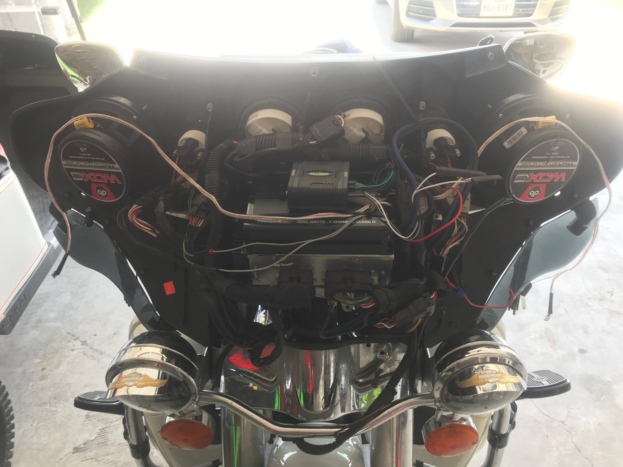

Has anybody been able to mount the the DB drive neo4 in the fairing of a pre Rushmore year ultra, without it hitting the outer fairing cover? I have mine mounted on top of the factory radio pushed all the way back and it is hitting the outer fairing cover.
If if anyone has been able to make this work I would appreciate it for some ideas.

Post some pics of your install. I have never seen the amp so pics would help with ideas

Here is a quick mock up, not finished with the install yet, once i figure out if this amp can be mounted there i will clean it all up

That amp is bigger than the SS pn4.1000d that barely fits under the hood. Take the headlight out and check clearance. I have a 2012 and the Soundstream is tight.

yeah i looked at it and the front fairing cover is hitting both the left and right corners of the amp.

You will probably need to trim the back of your gauges to get it to slide in a little further.

yeah i had thought about that but didnt know if it would affect the mounting of the gauges or cause them to shake.

Won't affect them at all.

i will look into that. it looks like if i can move it about an inch or so back it would clear but wouldnt know until actually done.
