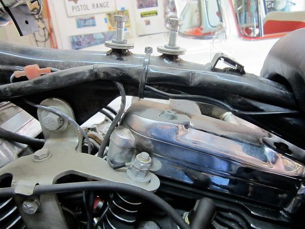

EVO style tanks and mounts are different than Shovel or Pan style tanks and mounts (pic is from an 88 FLSTC).
