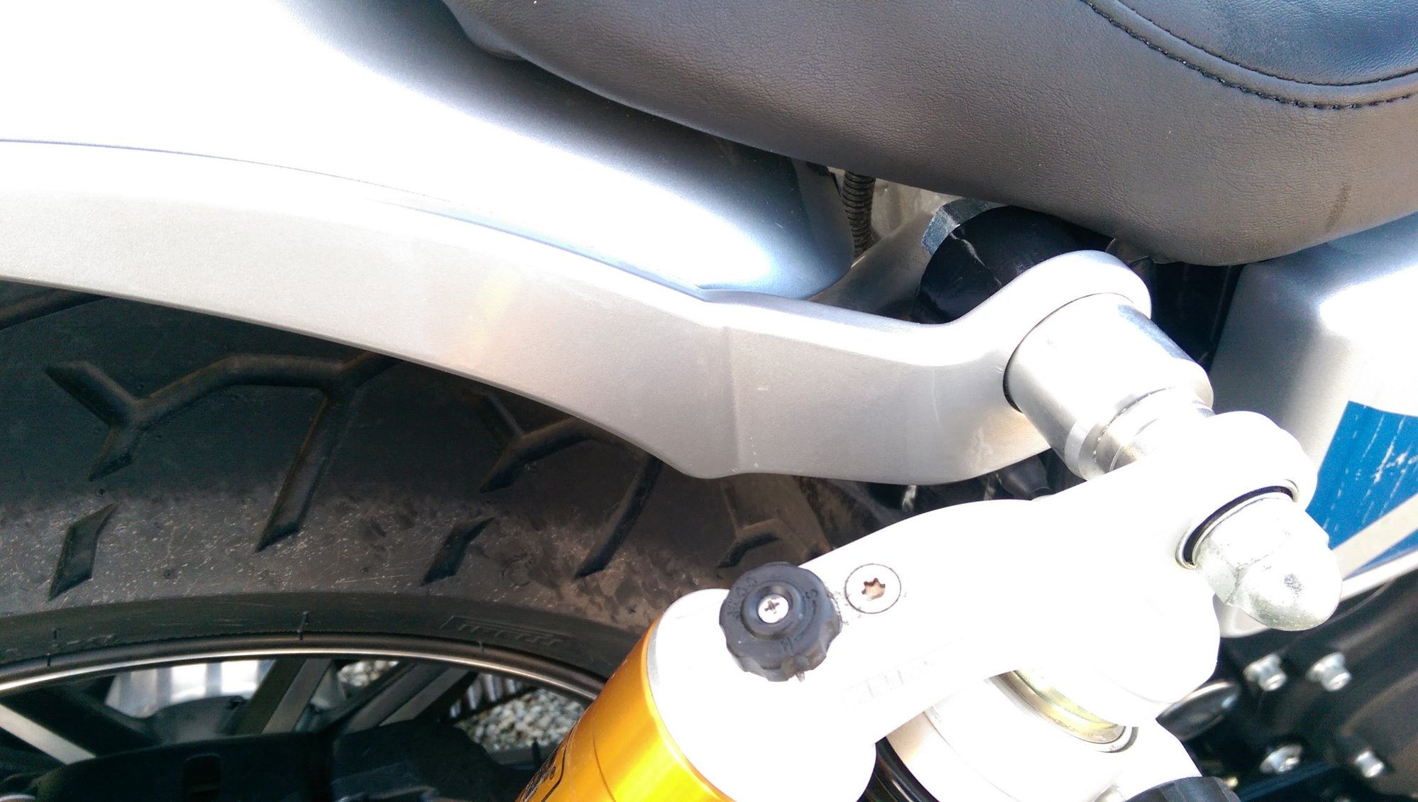

Okay guy's, it's a Voodoo fender and the light bar/ kellermanns are also from Rocket Bobs. Only fabrication was cutting struts off.The mirror is from Joker Machine along with the billet grips. I had to drill the hole on grips.
As far as wiring, cut it down to last plug from main harness, it took a few tries to work properly. Can provide correct wiring if needed, just let me know.
I haven't been able to ride my bike with the Voodoo because the tubes welded to the struts are off set and hit my tire no matter how I adjust the height.
Are the struts/bracket still mounted to the shock mounts? I can't see in your pic. Rock Bob is making me a new strut/bracket that has the tubes welded inline like yours. If this is how he is doing mine the tire problem will be solved.
Thanks

Thanks Dequello68. Great pics of the bracket.
My new bracket should look like yours, tube wise. My frame is an 04. Pete had to make me a different bracket because the newer frames, 06 and above was changed. Your is the first I've seen with the new tube configuration.

Here's a better pic for you firecop
