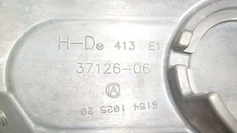

Does anyone know what year/model Harleys (Dyna or Softail) had the silver painted engines with the plain transmission side cover, shown below? (paint has been stripped from this one)
This is the same 37126-06 casting used for the chrome or black covers with "Six Speed" engraved on the face.
Trying to find another cover, or the part number for the cover. (37126-06 is just the H-D casting number, but not the finished part number.)

2006 on Dyna's and 07 on softails

06 FXDI was silver
07-10 FXD was silver
07-11 FXST was silver
All of them are P/N 37129-06

Looking for another one. Wanted to go polished, but this one had some dents under the paint.
Thanks to the others for the part info.

Thanks for the info, and the link to Ronnies. I had checked there, but all the diagrams had the "Six Speed" showing, so I couldn't be sure if it was the plain version.
Appreciate the help!
