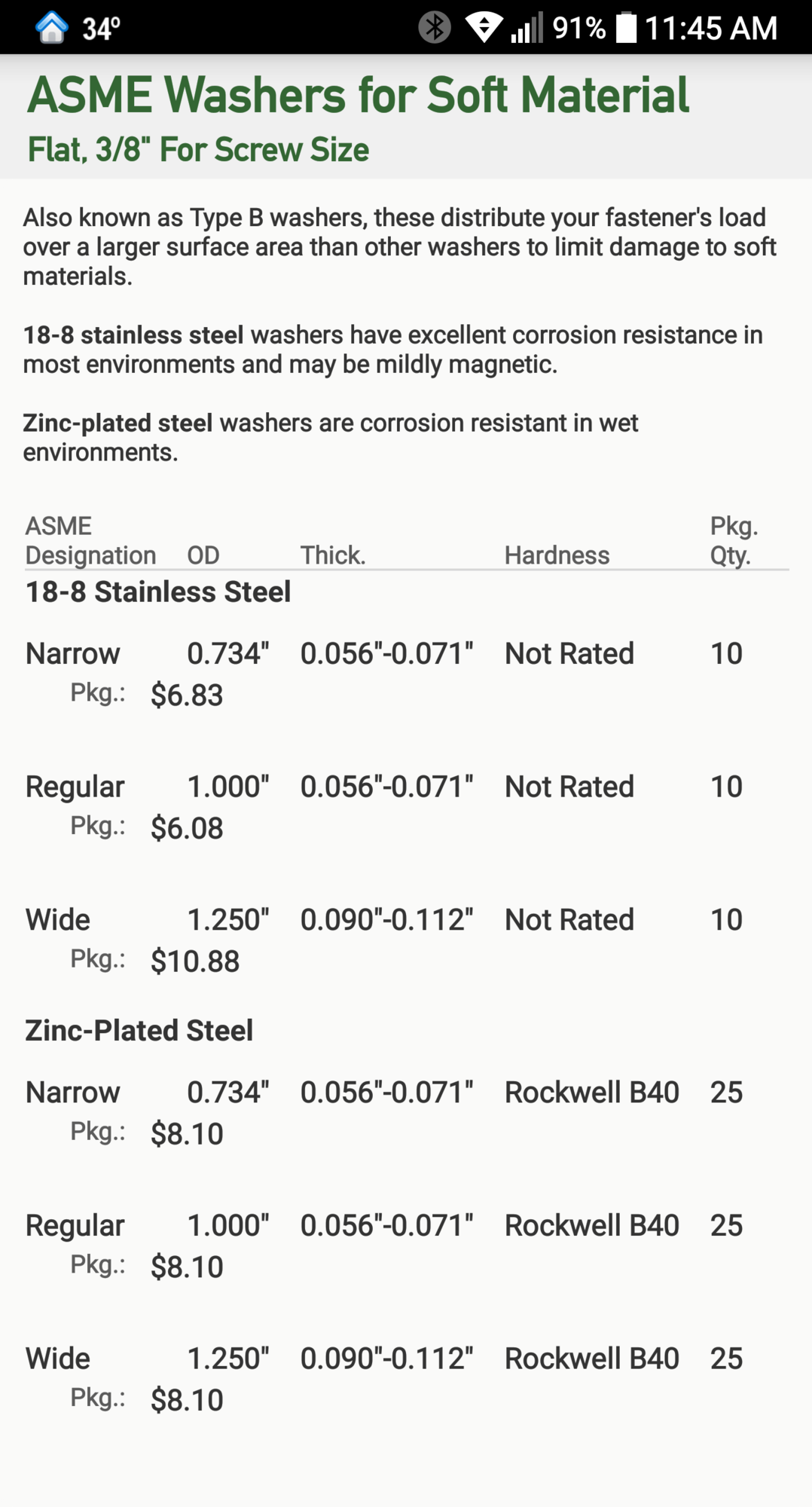

Yeah, MoCo uses heavy washers. I'm not completely sure why. It may be to limit the potential for fracturing of the pulley hub since they are likely cast. May be to spread the load further to help prevent flow and loosening if the pulleys are too ductile. Regardless, heavy washers can found in nearly any size, thickness, and material combination at places like McMaster-Carr.
Just a few examples...

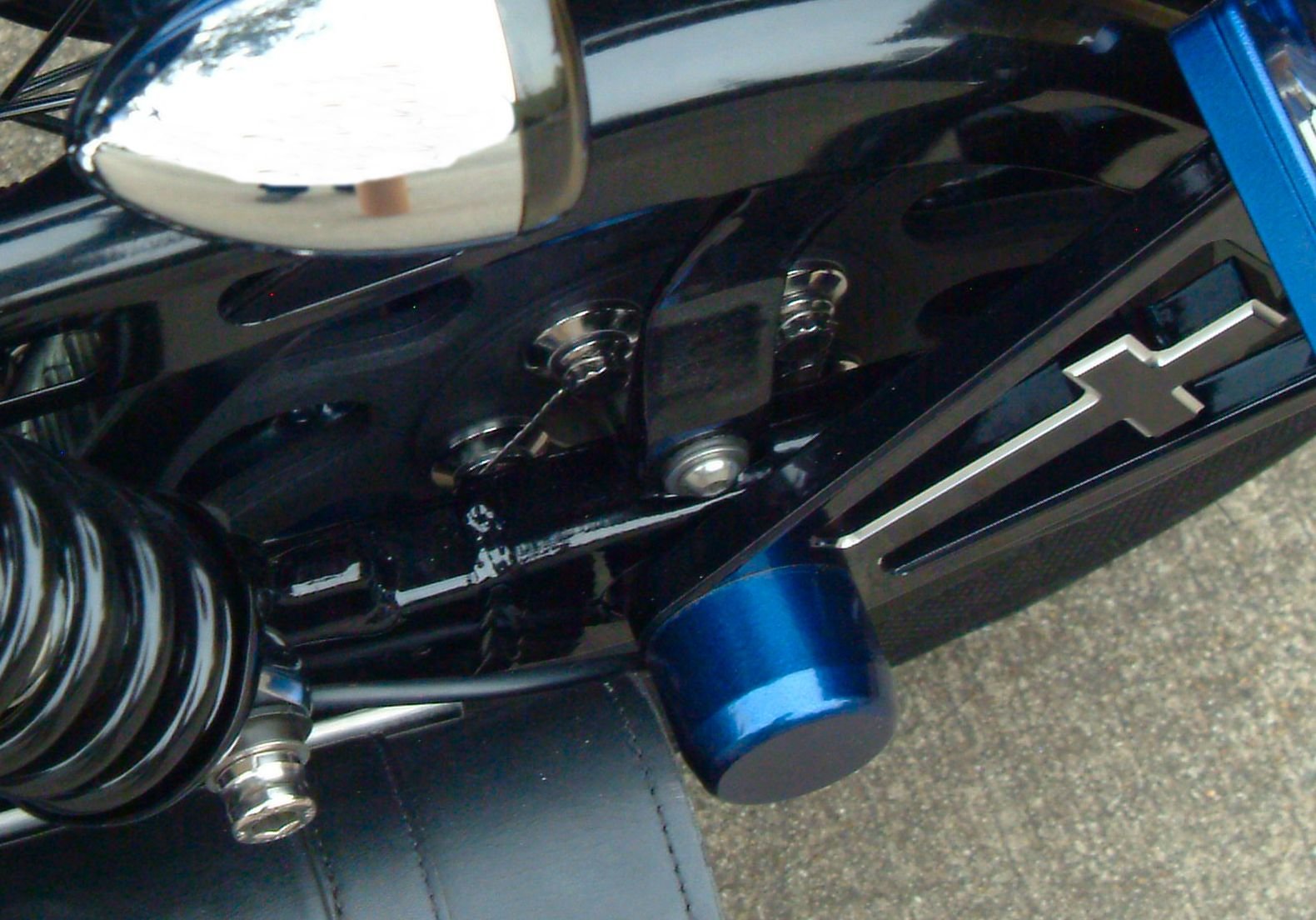

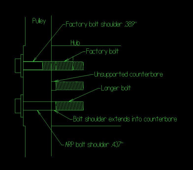

I used longer ARP bolts so the bolt shoulder (unthreaded portion) entered the hub. Now the hub is being driven by the bolts strongest area without the threads acting as a stress riser. I then bushed the sprocket holes down from .460" to.440" to tighten up clearance with the full .437" ARP's. Factory sprocket bolts are wasted (smaller in diameter below the head) and only measure around .390" which makes the bolts LOOSE in the sprocket.
I also drilled and safety wired.

I made my own 316 SS .875" x .187" I also believe larger diameter helps with load distribution but strongly feel the loose fit of the factory bolts and exposed threads inside unsupported holes are the main culprit of loosening and sheared bolts.
