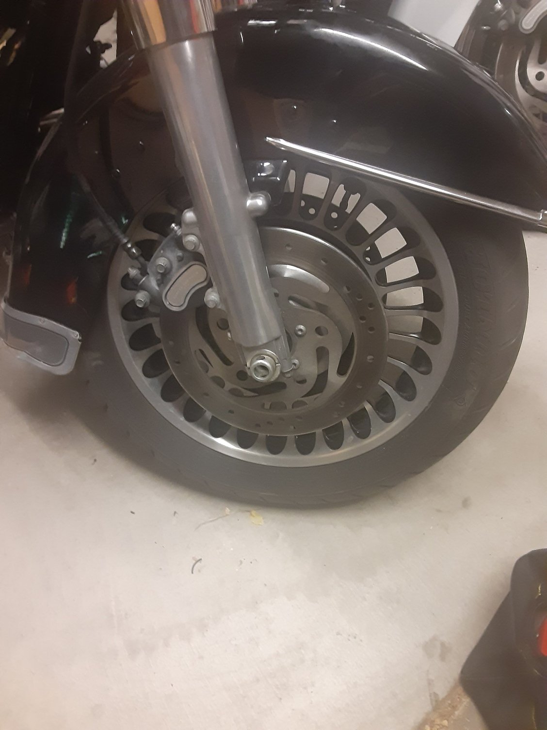

I am putting a 21" fat spoke front wheel on my 2006 flhpi but whomever got this bike from the police changed the front wheel out to what looks like a post 08 18" eltroglide but my forks are the same so im enclosing a pic of the wheel to see if anyone knows if this wheel would have the 1" bearings in it or did they change the axle or does anyone know if it's possible they just threw the wheel with the 25mm bearings on the bike on the 1" axle?? I'm super confused I'm just going to take it all apart and find out if itll work I guess
The later model wheel on my bike 08 and up?? It is an 18"

Your current front wheel being shown is a 2009-13 17" ... and that's a 25mm axle being used.
25mm and 1" axles have the same OD where they "mate" with the sliders, so you can do whatever you want to do
well it's actually a 18" wheel but yes I figured that the 1" axle is actually solid on the end correct?

Check that wheel again ... I have never ever seen that 28-knuckle wheel in a 18"
absolutely correct it is a 17" I stand corrected!! but the axle will have to be changed for sure then???

Yes, if you want to use 1" bearings
