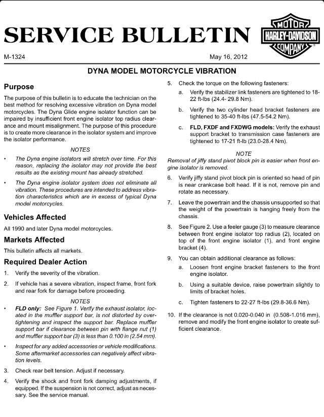

This is the service bulletin on Dyna vibration, it will give you an idea of how to inspect the isolator. If you do find your isolator is contacting the engine bracket transferring vibrations to the rolling chassis the HD approach that's shown in the bulletin is a band aid; replace the mount I've got Predator front mount in my '13 and I never looked back

you can hold off. id just be looking to also replace the rear by winter. in my honest opinion you should change both anyway. the dealer replaced just my front under warranty and i had to bring it back for the rear not even a month later.
predator front and shave the hump off of a NEW rear mount just like that service bulletin says for the front and you will have a setup that will last you the life time of the bike. ( and be super smooth lol)
