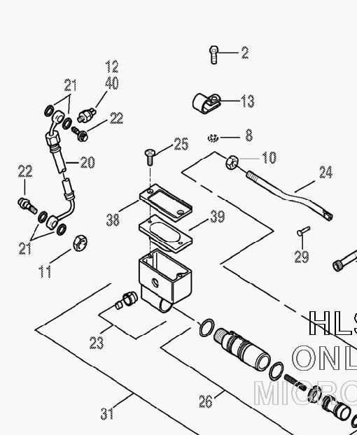

If I recall correctly from installing my True Track stabilizers, the rear brake caliper on my 2003 SuperG mounts by a single large nut on the rear of the caliper to a bracket that's built into the frame. I wanted to pull that caliper loose to get more clearance for installing the rear stabilizer bracket, but didn't want to risk breaking the hydraulic seals and adding one more thing to the project.
Two pics from the microfiche below. I think the mounting nut may be number 11 in the first pic. I circled what I'm guessing is the mounting bracket/tab on the frame for it.

AJSSV thats how mine is with the one nut that holds it on. It looks like master cyl body #23 is moving on insert #26
