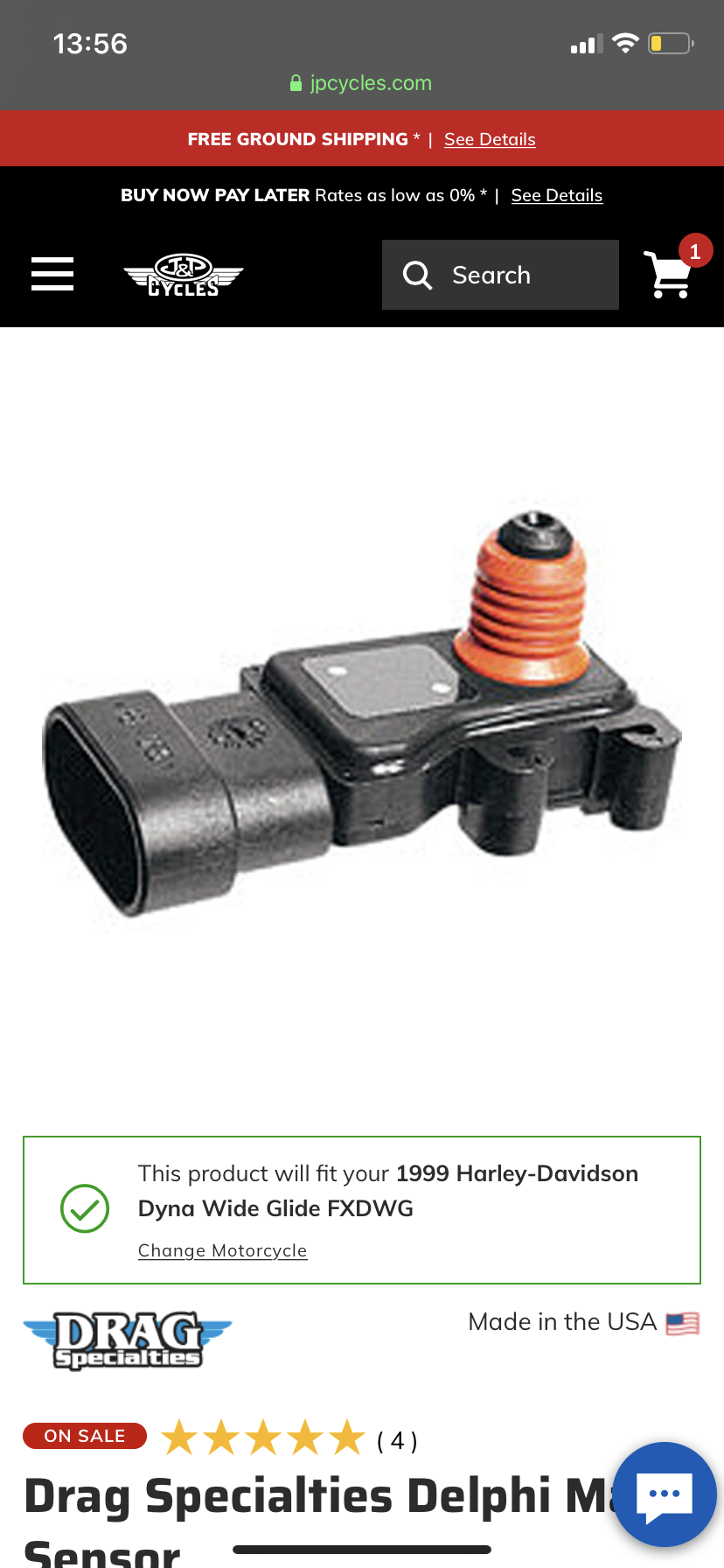

Hey guys / gals . I’m working on my 99 dyna . It’s bored over to a 103 , stroked , cammed bike has ran after build for a few years pretty strong always keep up on general maintenance such as oil changes , plugs , wires , battery on a tender when parked . I started to notice it would run sort of “poor” or less power threw out the throttle ranges then one day it wouldn’t fire up at all and would cough out the carb with a few turns to the motor while trying to start. I went right ahead and replaced all the gaskets from the intake manifold , carb , air cleaner . Still same symptoms . I’m curious as to if a bad map would do this . The bike has no voes sensor . I don’t want to buy a bunch of parts if it could be something else that I’m missing but I think it’s a map but have no experience with one going bad yet .
I also cleaned and checked the carb for leaks it checks out good

it has a map sensor on top of the intake manifold it’s a 3 prong sensor sets on top of intake manifold with a screw

Issue has been resolved my buddy let me swap out his map sensor with mine and it fired up and runs smooth thanks for the help guys
