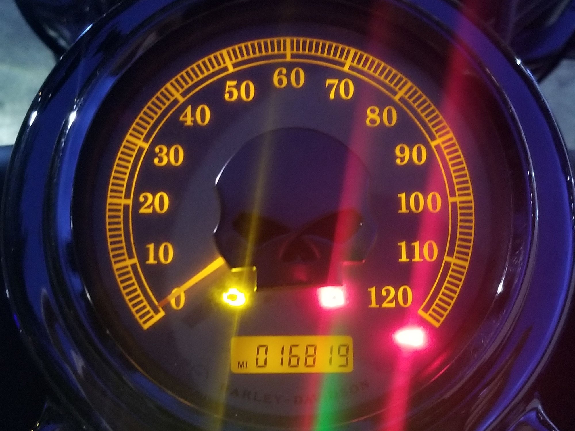

Fellas...I could use some help....what does this mean? Battery light and check engine light came on....pulled battery and charged it....checked battery checked out good...put battery in rode 20 miles home from work no lights....next day after a few miles the lights returned....I checked all battery connections and voltage regulator.... any thoughts or ideas....its got me afraid to ride further then I can walk home.....lol

P0562 Battery Voltage Low
P0563 Battery Voltage High
From another thread:
Originally Posted by grumble
I've got a 2010 FXDF with 27,000 on it. About 2500 miles ago, it started with the same thing (P0562) - both lights (battery and CEL) would come on, then go off after awhile.
It started then occasionally throwing P0563 (voltage high) code. At this point I suspected a weak/shorted cell in the battery (had already tested VAC and continuity on the stator). Bought a new battery because it was the cheapest part to replace (a little voice inside my head kept saying "regulator, regulator, regulator"). 20 miles down the road and the same thing.
Replaced the voltage regulator and 2400 miles later she's running just fine. Also, a note - HD has updated the part number so obviously improvements have been made.
C note says it's voltage regulator.
