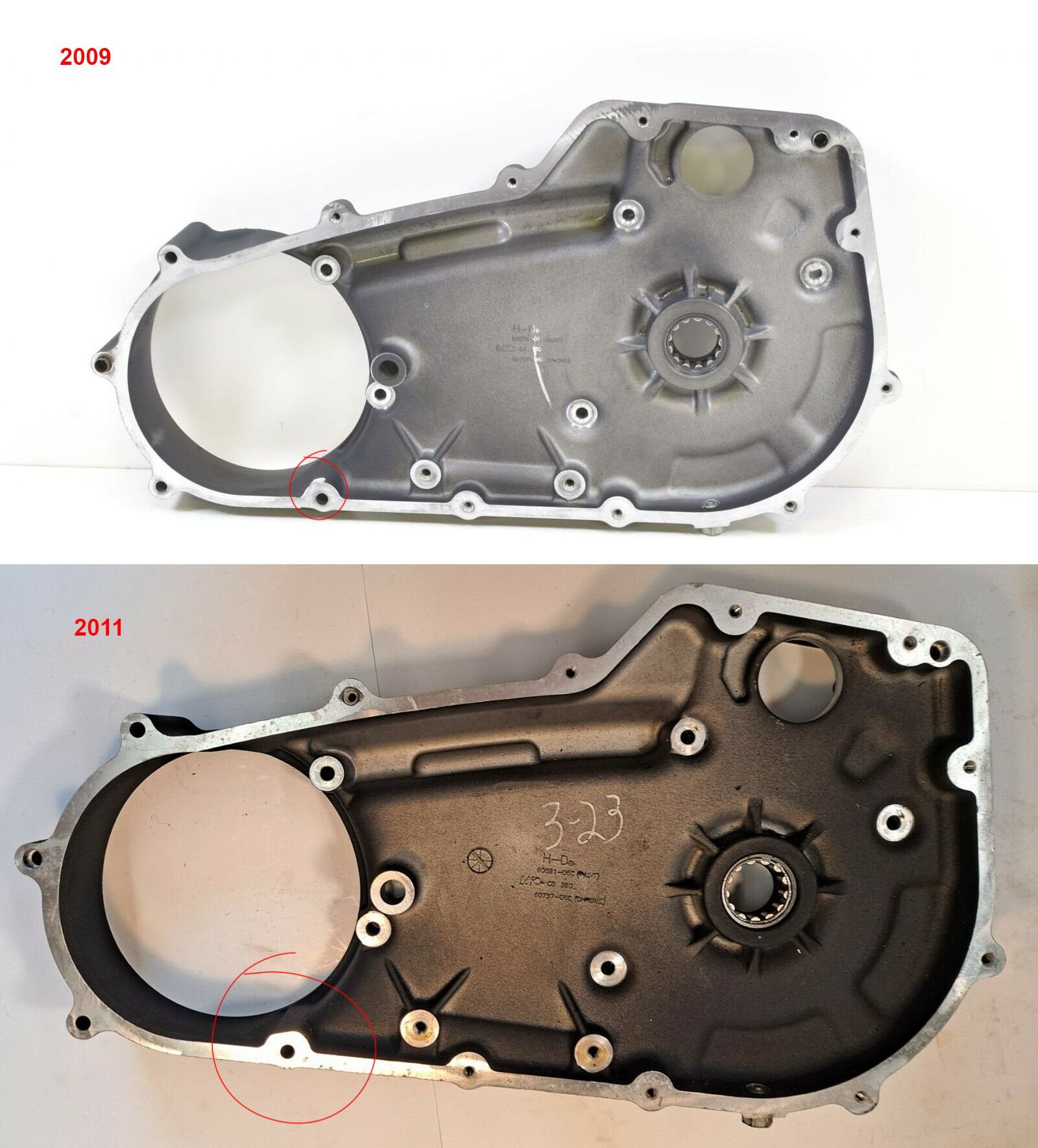

Hello!
I ask for help / advice. Street Bob FXDBI 2006.
Such a problem appeared, the primary began to work noisy. The noise was similar to the bad primary inner bearing, but I had already replaced it with Baker bearing and the OEM 39929-06 auto-tensioner (with a thin base) was replaced with the updated 39929-06B auto-tensioner (the one with a thicker base).
I removed primary cover, I saw that the chain was hitting inner primary case under the compensator. Therefore, the noise.
The problem is the tensioner and need change it to Hayden auto tensioner or any other? or is the chain too stretched? Or is there something else?
By the way, if you look at used primary inner primary cases on ebay, then there they are also often found with these marks from the chain, and inner primary of more recent years of release have already changed the design of this place.

Originally Posted by Valv_Kain
Hello!
