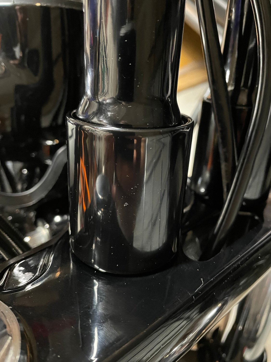

Ok parts came in from Dennis Kirk (ordered a day later then the other parts from revzilla, the incorrect parts I ordered from rev won’t arrive until Tuesday)
if you have a 2017 Fat Bob here is the deal.
if you want the LA Chopper riser spacers that the bars/risers recess into you need p/n
LA-7413-73B.
They are for 1.75” bars. You are thinking the Fat Bob has 1.25” bars so these won’t work. The bar diameter only matters it you’re running a T-bar or similar.
On the Fat Bob the important parameter is the riser diameter. The riser diameter is 1.5”. So initially I ordered the spacers for 1.5” Bars. They still haven’t arrived but aren’t going to work.
The bottom of the risers flare out to 1.62”
I’ve seen YT videos of people installing these on the Fat Bob upside down with the recess down over the bushings. My assumption is they assumed they ordered the correct part based on riser diameter not accounting for the flare and this is the only way they fit.
on most risers that are just a cylinder the diameter is not critical larger or smaller will work but may not have a pleasing look. Since the LA Chopper risers have a recess the bar/riser sits in the diameter is very important.
I was concerned the 1.62” diameter base would be too small and look odd in the 1.75” recess but it looks perfect. The OD of these is 2” they look beefy and awesome.
also installed drag specialities poly bushings p/n 0602-0067. These reuse the factory hard parts and are cost effective. The bar is much more rigid than with the factory rubber bushings. Hopefully these will still dampen some vibration and be a good middle ground between metal bushings and factory rubber.
Used a 12pt 1/2-13 5” bolt from McMaster Carr p/n 91271A732. I think the 12pt head looks cleaner and it’s black
Cables. Only one that is even close to being tight is the clutch. I removed the plastic clamp at the bottom of the frame and adjusted the clamps on the downtube. I think it’s fine now and I still need to slightly change the angle down of the levers so that will give a bit more wiggle room.
I hope this helps those out these with the real Fat Bob (Dyna)
Now to get the DK 2” tank lift ordered
