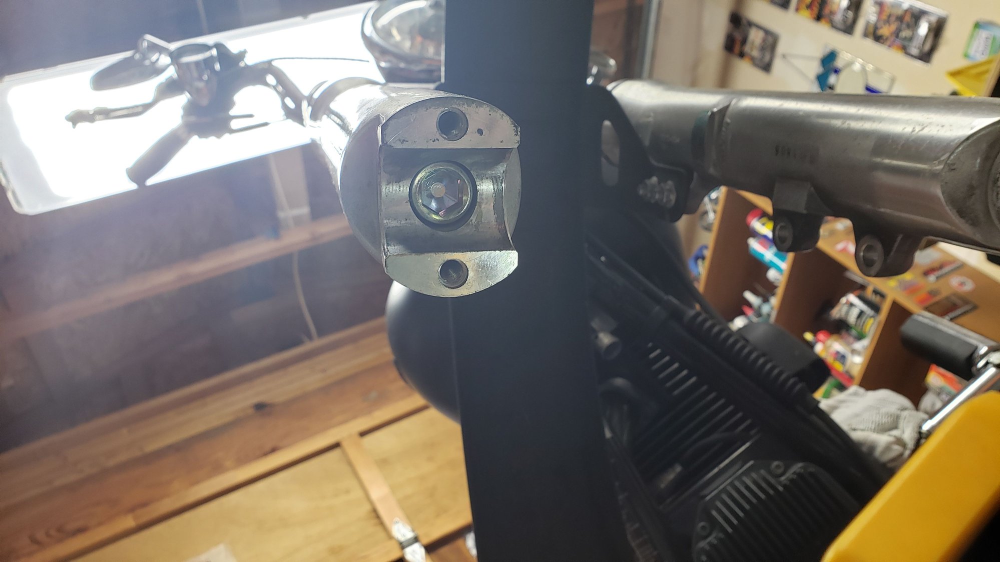

I have not had a dyna since my 1998 Dyna Wide Glide. I traded that bike in 2010 and got into the touring models.
Miss the ol wide glide once and while.

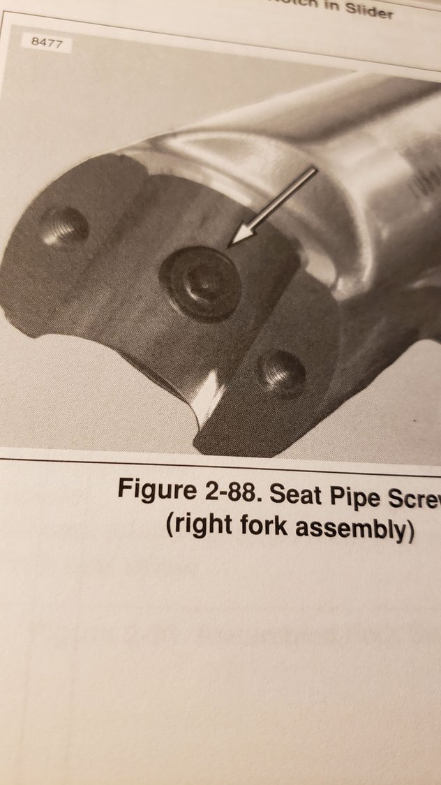

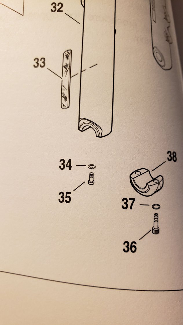

Anyway working on a 2006 street bob with a friend installing the progressive mono tube. Can anyone tell me what size this bolt is? Its called seat pipe screw in manual. Even the picture in the book shows a much smaller bolt than what is actually on the bike. I am going to attach pictures. It's the bolt to come up through the bottom of the lower fork holds the damper and internals. The size of it caught me off-guard I was expecting a smaller one like on my Wide Glide.
Thank you in advance.
#35 in manual
Bolt looks smaller in manual.

That Allen is a 12mm. I remember having to order a longer than normal Allen socket to get them out when I did my cartridge kit on my 06.

Yes I know the left fork is about 2,25 in. Minimum To reach the 12mm bolt.

I couldn't find a 12mm bit long enough for the left side slider, so I bought a standard 12mm L-shaped allen wrench and cut the long straight section off, and use that with a regular 12mm socket.

Exactly what we are doing.
