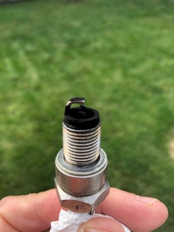

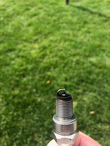

After taking the advice of most I changed my jet from 48 to 45 and this is what my plug looks like after about 150 miles. Does this plug look like it should and if not what is the problem ? I went through the whole carb and cleaned it changed spark plug wires.
Old Oct 14, 2024 | 11:54 AM
  #40
NORTY FLATZ's Avatar
NORTY FLATZ
Joined: Jan 2015
Posts: 15,928
Likes: 7,022
Carb?
