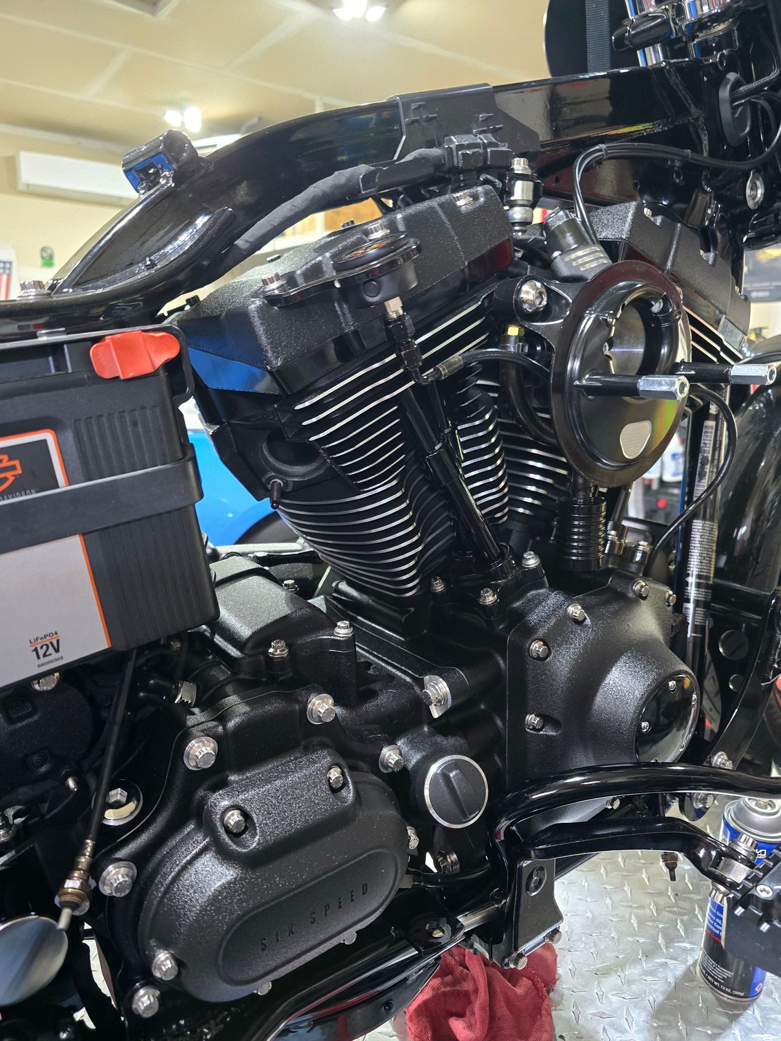

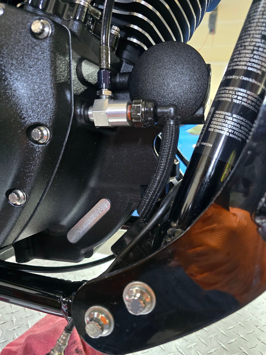

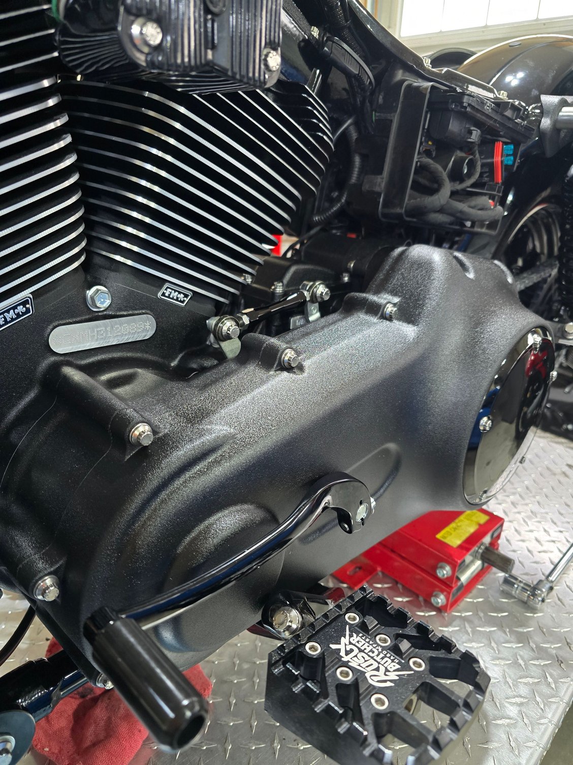

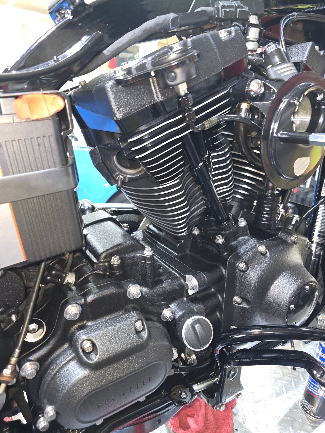

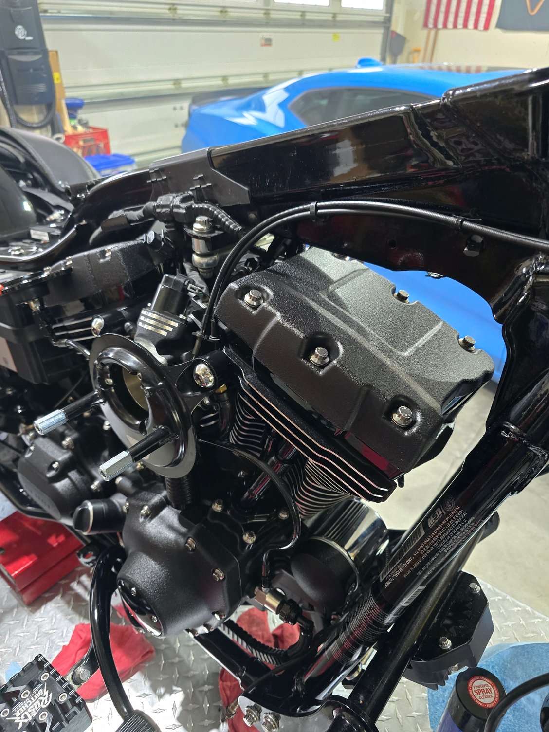

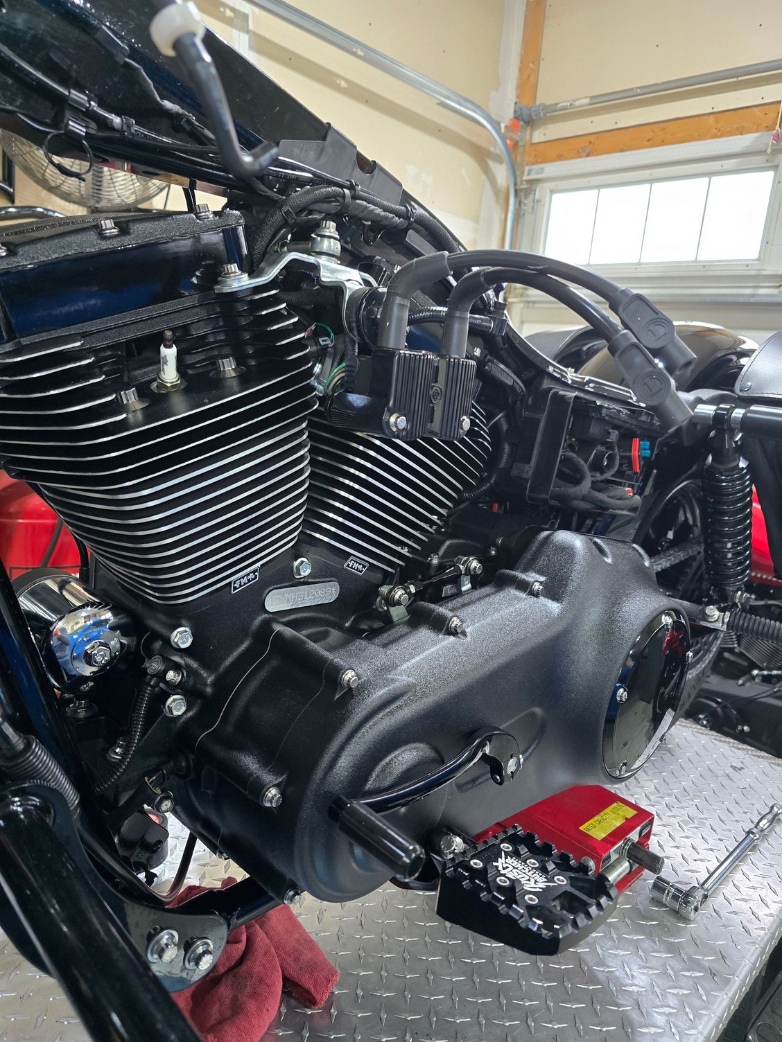

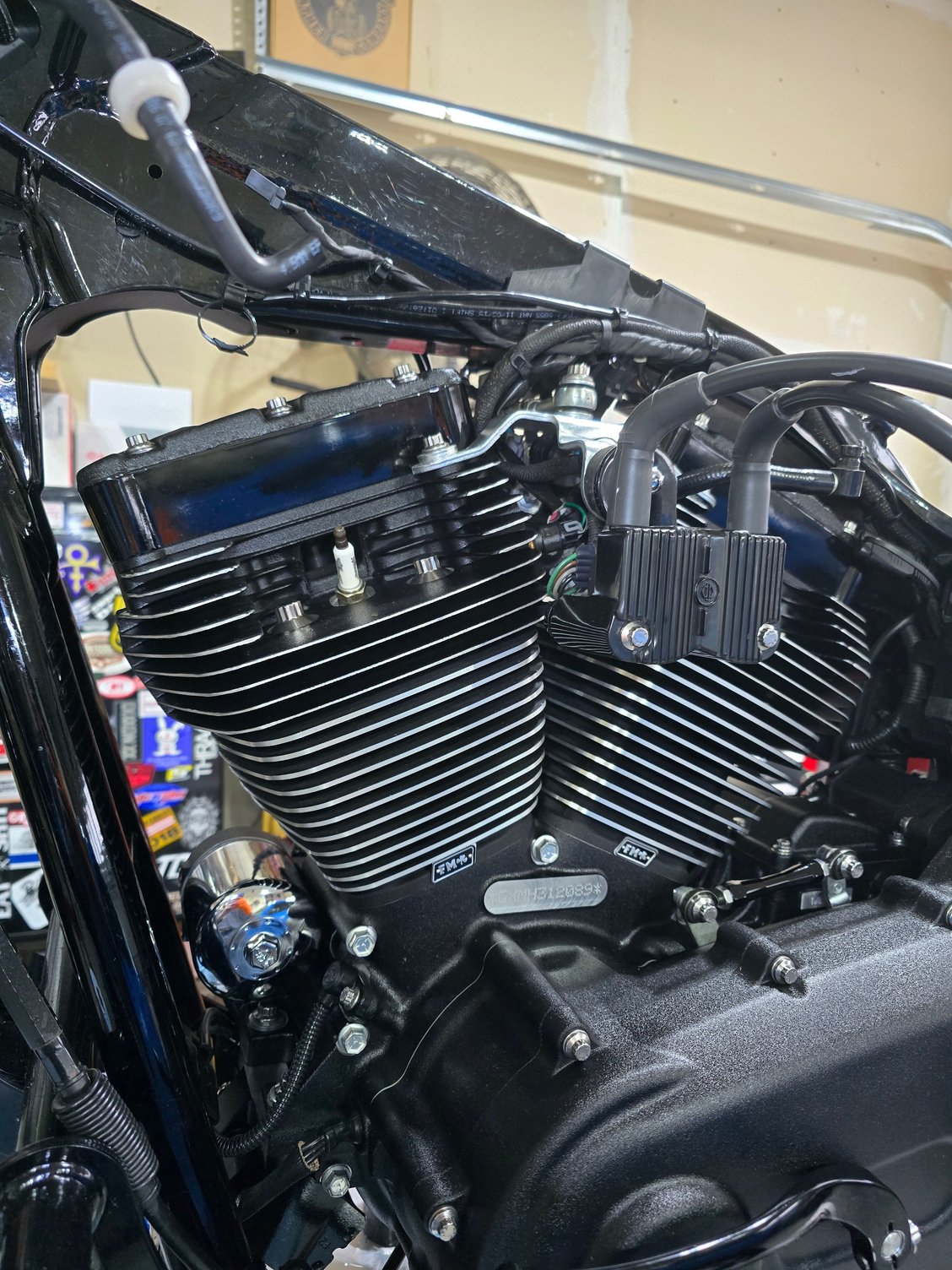

Thought I'd follow up. I showed the post cleaning pictures earlier in this thread and here's the finished product, well I haven't polished the shiny bits yet, but all the wrinkle black is done. I hosed it down with Harley engine brightener, which I believe is S100 and since I'm lazy and in no hurry let it sit for the last month or so. I did the excess wipe off before these pictures and anything else will burn off on start.

Likes: 3,554
From: Idaho
Looks great!

You might be right about the cause, but did you see my before and after pics?
I agree, looks great..just avoid rain or you will be doing it again.
