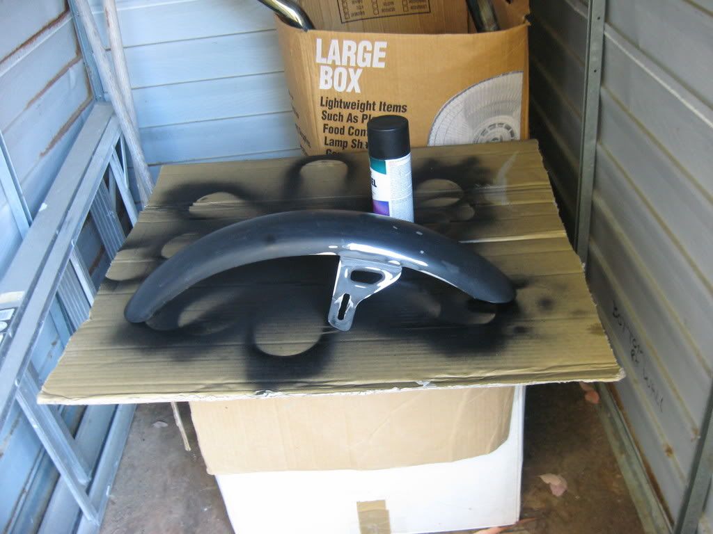

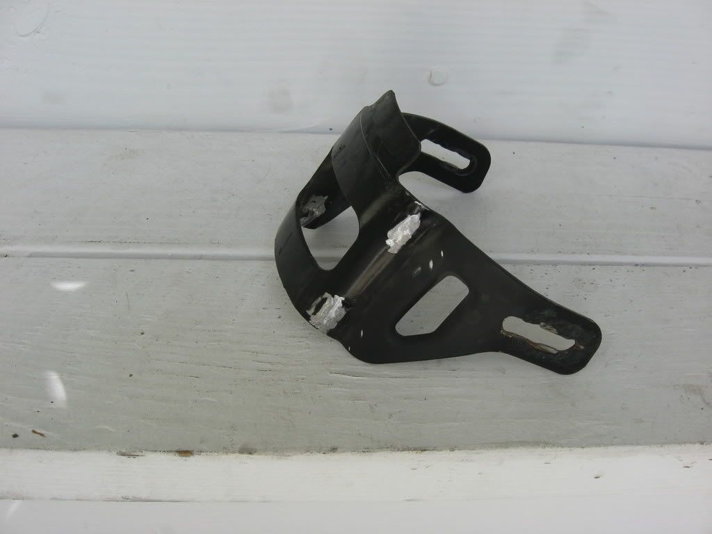

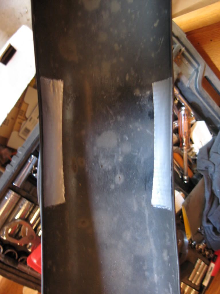

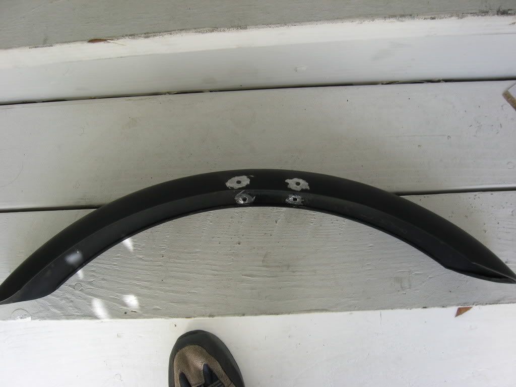

My front fender is JB welded and has been since last summer.If you strip the paint off the contact surfaces it'll stick.Check it out, the picture with the duct tape was from when I filled the holes from the top.I then stripped the paint off everywhere the bracket touched the fender and used JB Weld.I also rotated the fender back by about 4 inches as you can see in the last pic.
