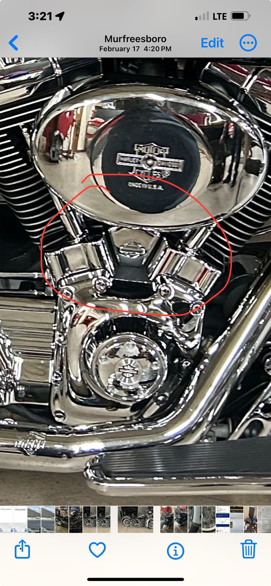

I cannot for the life of me get this trim piece off so I can access the lifter boxes. Two small screws removed one from each side bit it appears to have a set screw in the center. I think it may be only accessible from the left side of the bike but I can't really see it just assuming. Any tips on removing this trim to get to the lifters?
