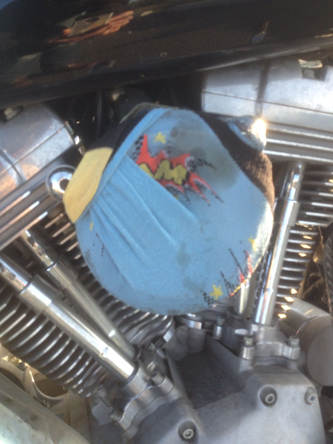

Default Big Sucker Fell off!
I was out for a ride recently and my filter and cover fell right off! Luckily it landed on my boot and I was able to hold it until I could pull off the highway. The bolts had all snapped. I put a sock over the intake for the rest of my three day ride. The parts guy at Harley said this was common with Arlen Ness bolts on a rubber mount. He showed the hd bolts and they are a two part system that apparently negates the vibration. Anyone else have this issue on a dyna? I bought my 2007 FXD used and it had the big sucker stage one on it already. I had already ordered replacement bolts for the Ness so I'll stick with these for now but it was a real pain drilling out the snapped off bolts!
When in doubt, use a sock
