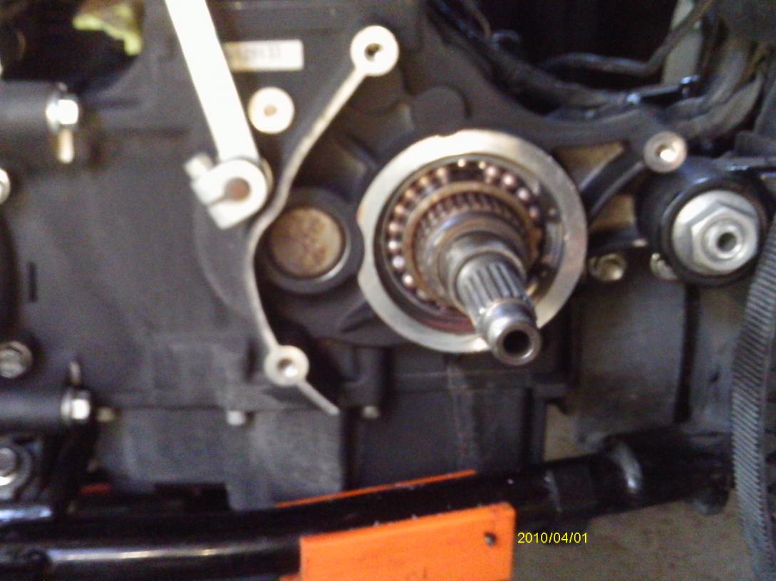

Here's some pic. of the bad bearing. I'll try to take pic. as I continue deeper.

Originally Posted by SC-Longhair
I'd assume this is the infamous "inner primary bearing"?
Negative, it's the main drive gear bearing. It's behind the trans sprocket. The IPB is pressed into the back of the inner primary case.

... and try to find a bearing that has a metal retaining cage instead of plastic, to go back in maybe...?
