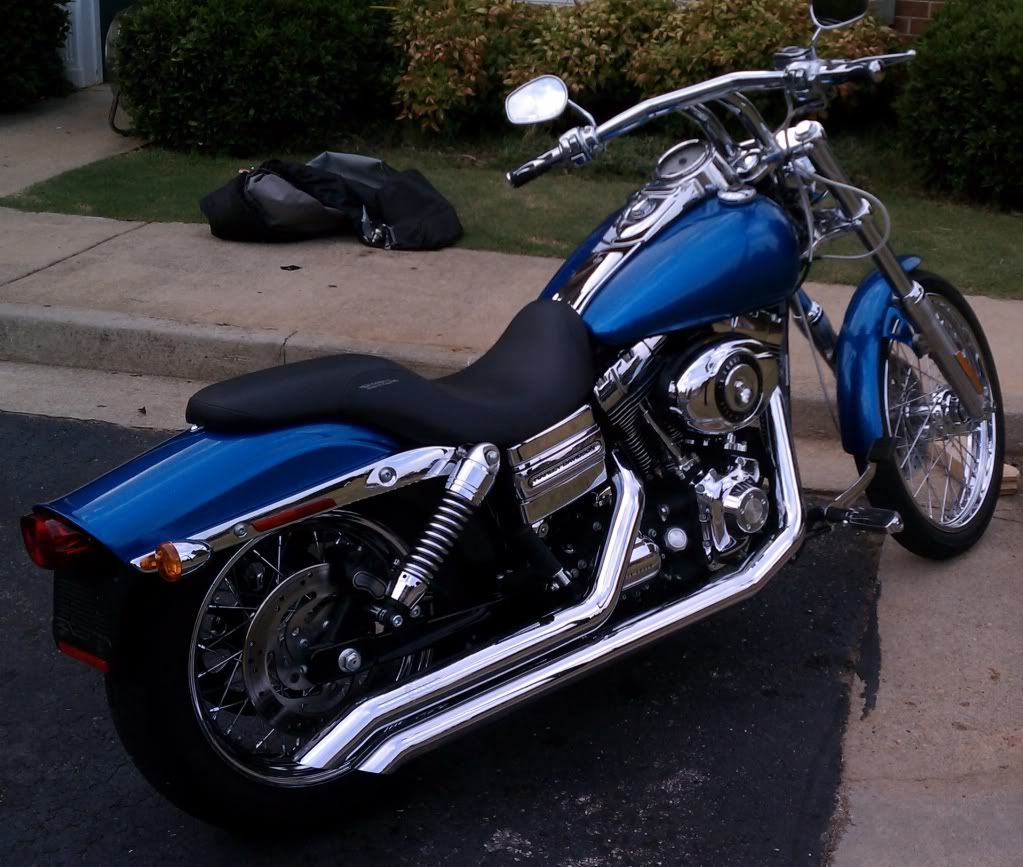

just did mine today!

Looks good Keith!

Looks goods, happened to notice your front brake cable looks extemely tight in this pic you got enough slack in there? No trying to be a pest just trying to help a fellow rider. Maybe an illusion just checkin
