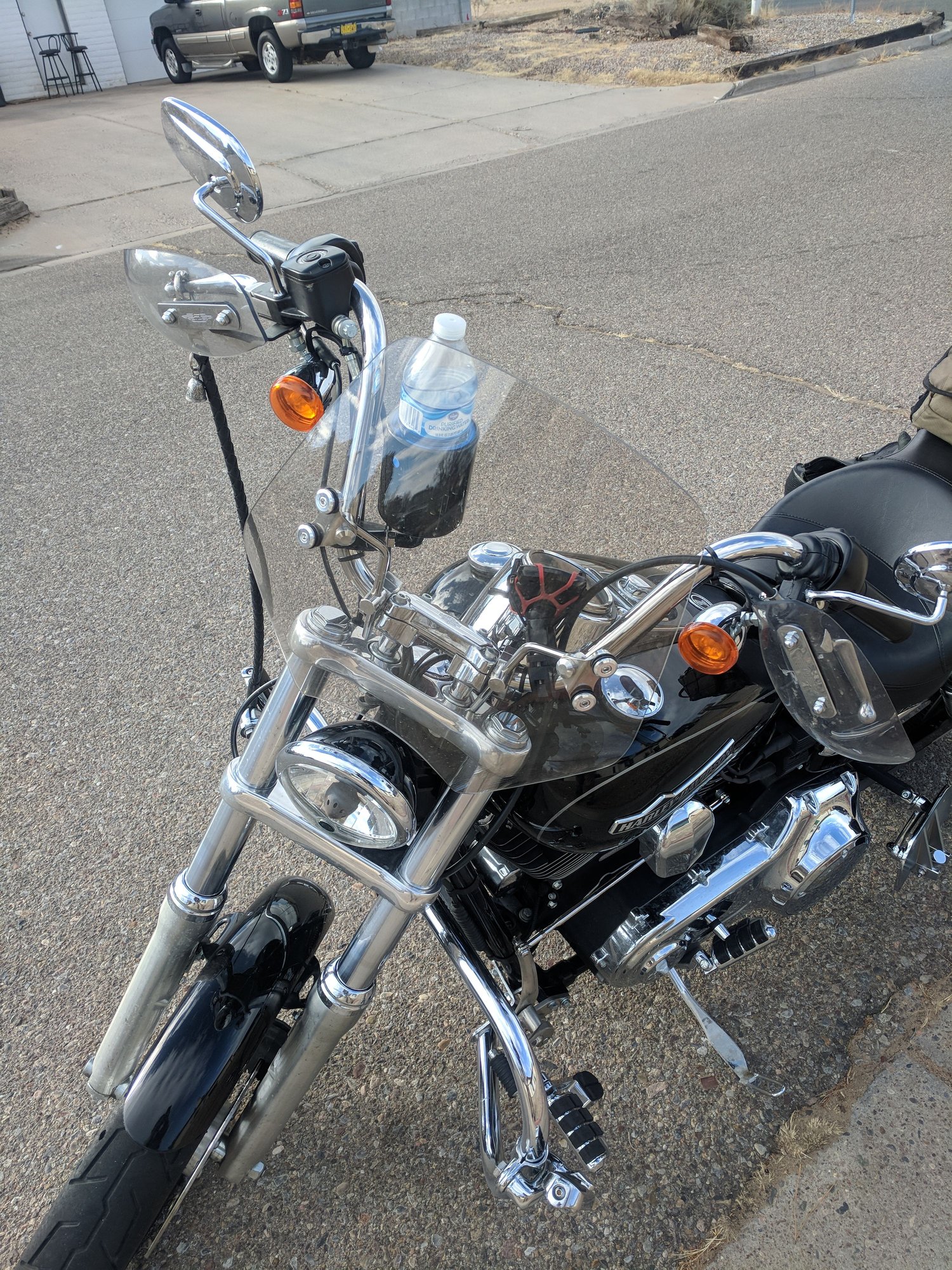

I have engine guard on my '13 Super Glide with forward controls. The bottom of the engine guard mounts to the front of the frame just above where the forward controls mount, so no interference. You can see the U bolts for it in some of these shots:
Shouldn't be all that different for earlier year models. Instead of going straight back to the forward control mounts, there is an L shaped bracket welded on, which bolts to the frame with U bolts.
