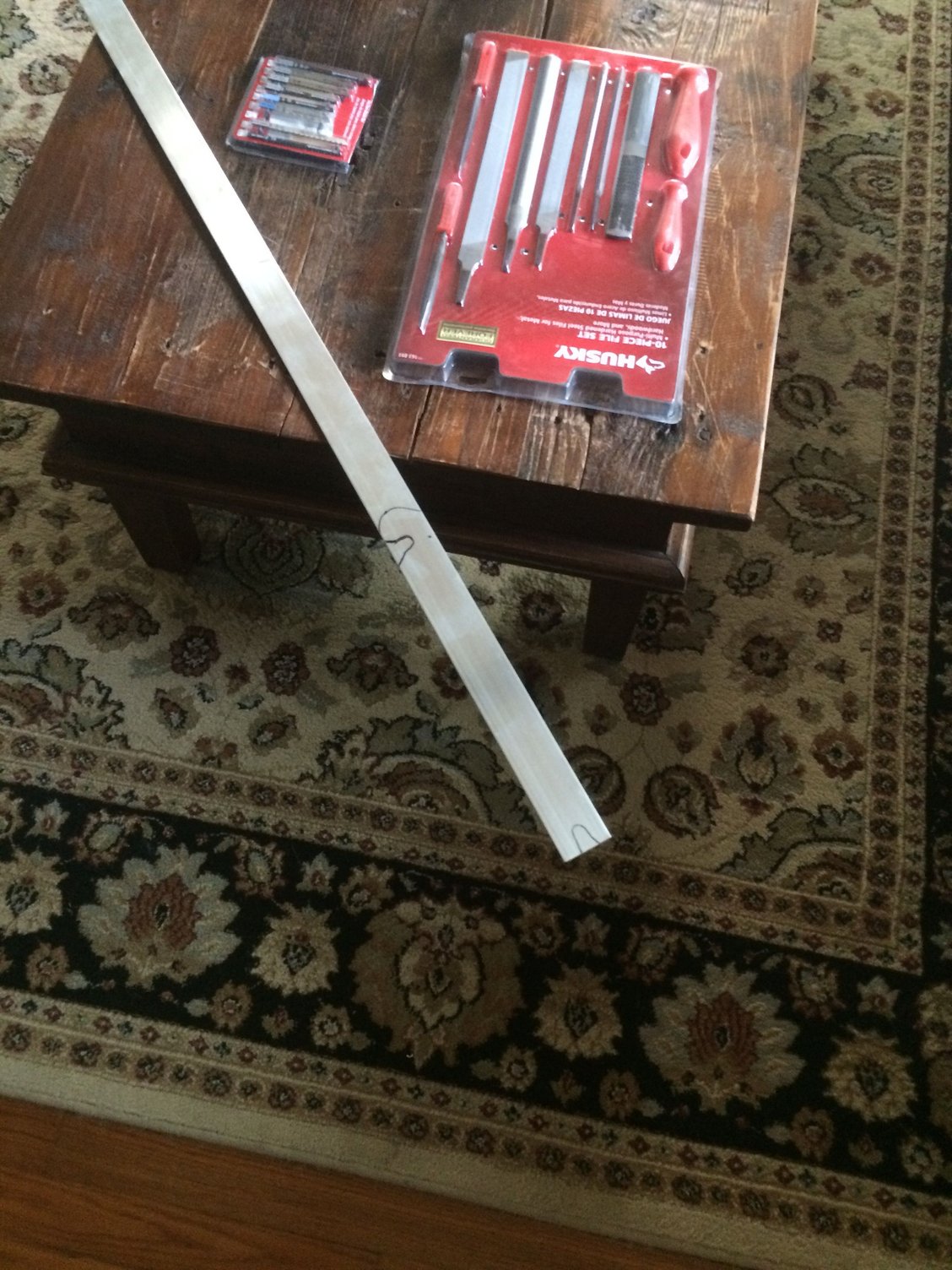

Default I know this is an old thread but here is what I got from you all :)
First I would like to say.. Thank you all for your posts..
It is great to see the ideas and what we can do with them as well.. here is my implementation of the solo bag on the quick release brackets (Almost complete I am still waiting for the rotary locks to arrive)
a quick trip to home depot for supplies $35 bucks
1 hour of drilling, cutting and filing.
1/8 aluminum piece, didn't have all the cutting tools so had to buy files and metal blades..
rough cuts and marks
Attached to the bag with stainless steel screws and nuts and plastic spaces.
Connected perfectly..
Velcro ties holds in place until quick release mech arrives next week
