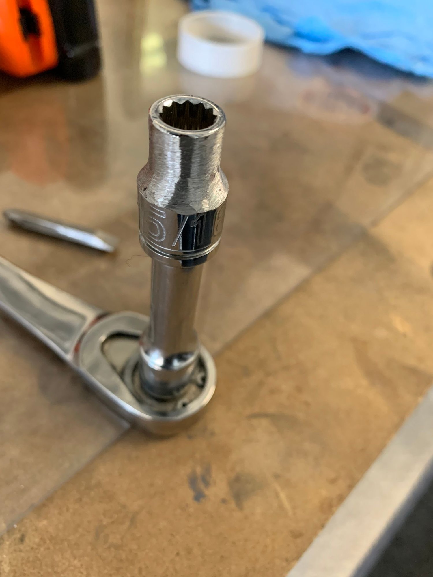

Several years ago I did a big bore top end. In the process I had head work done. While I was at it I had compression releases installed. A week ago or so the rear one must have backed itself out while I was out and about. I have new ones in hand, but the 1/2 socket won't fit over the button. I threaded it into place with my fingers until it wouldn't turn any more, but the socket won't go on to torque it down and now I can't back it out because the cap spins before the threads do.

Old Jun 23, 2019 | 07:24 PM
PWMORRIS's Avatar
PWMORRIS
Joined: Jan 2009
Posts: 714
Likes: 120
If ya can’t find em’, grind em’. Don’t let anything stop ya.....make it work. Any bolt, any time....
Have done it many times. Special XL long socket to fit very deep spark plug holes to fit between over size Jesel pushrods, front end/wheel stuff, odd ball fab stuff, even a specially modified socket wrench to fit into my dual carb manifold.
This scenario for example just came up to fit a narrow canal hole on a filler neck mod with a deep 12 pt.........
Used to fit into a narrow oil spout mounting bolt hole.
