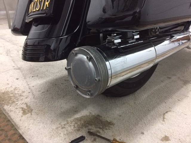

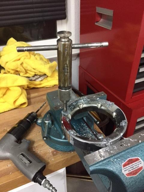

Back in the day there were a couple of mods to the earey (megaphone muffler) Propipe. The two most popular were the "lollipop" and the adjustable washer modifications. Both were effective in reducing or eliminating the torque dip that was a common characteristic of that pipe,adding a bit of low end TQ, as much as a 10ft.lb. increase without hurting HP; cheap mods but real gains. BTW, the early Propipe was a much better performing and sounding pipe than the current iteration. I tried the later Propipe on a 95" motor a couple of years back and hated the highway drone; got rid of it after my first highway ride at steady 75mph cruise. My brother still has the early Propipe and it sounds so much better.
The best mod to be made to the current Propipe would be to convert the end cap to accommodate discs like the Supertrapp. Easly and cheap mod that will make a real difference and makes the pipe "tunable" to marcodarqs point. Pictures attached; just a little work, some hardware and a pack of discs for the tuner to work with. Much better mod than modifying the baffle, covering up holes, etc.
