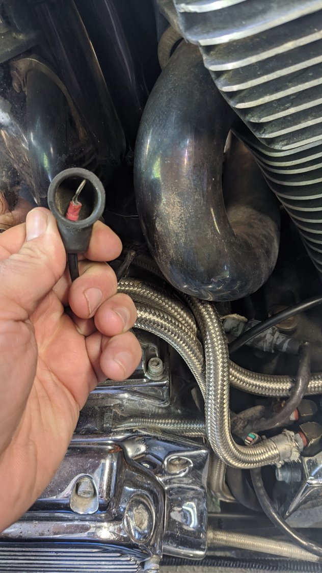

I'm going to end up having to replace a main harness on this bike as the wiring is all messed up I'm finding,
I did find a random wire unhooked down under the oil tank. No way of knowing if it's a ground or even needed I no can't find where it goes to. It's a single thin gauge wire with a rubber boot over it. I'm wondering if it's a ground for the coil or maybe whatever they module is under the seat that says screaming eagle with 8000 rpm on it
