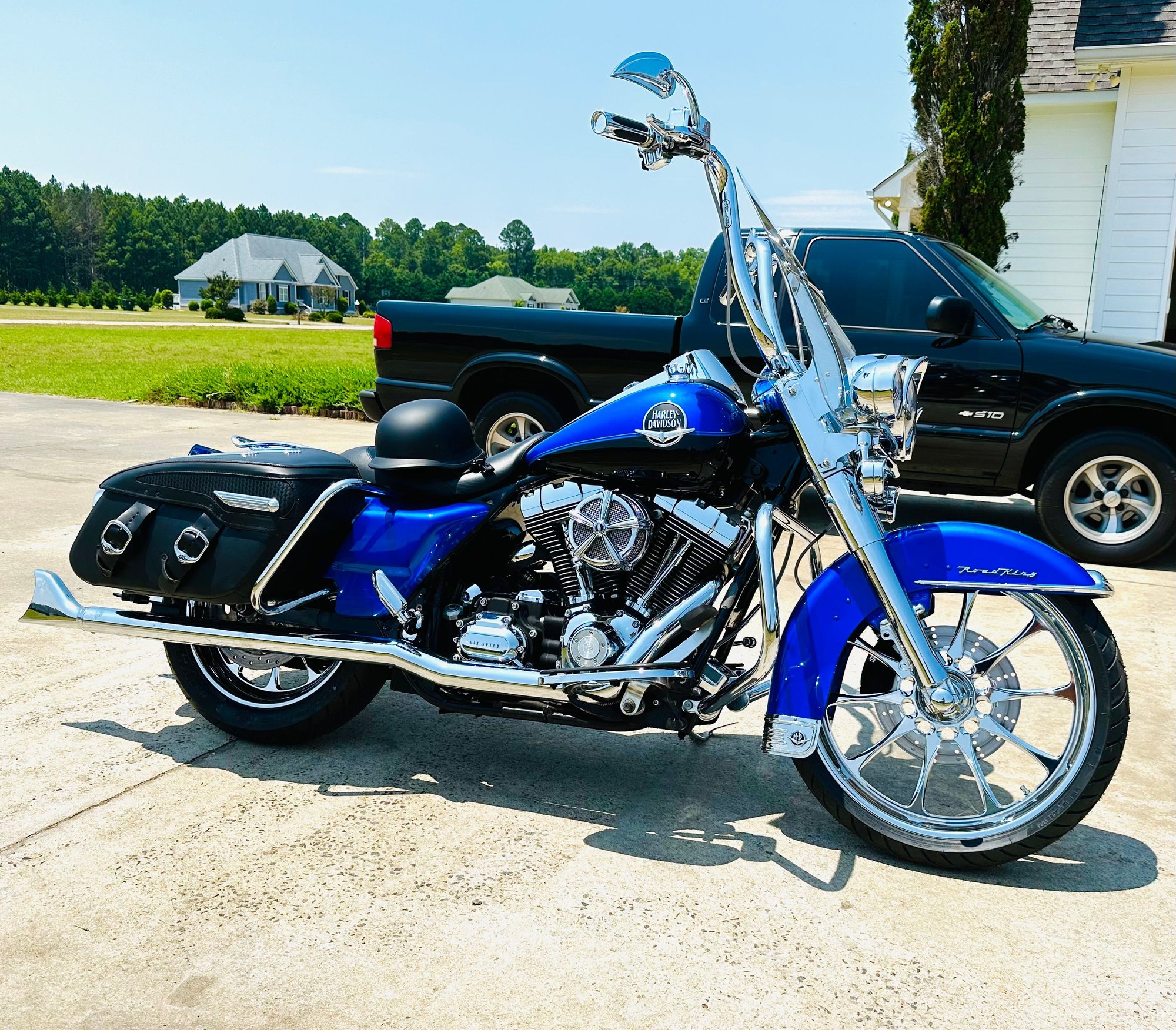

I have a 2008 RK with a stick 96”. I’m looking to replace the cams but honestly, I’m not so worried about the power gain (I don’t hot rod around) as I am a good sounding set of cams. I want to run the stock valve train as well. I have looked at the S&S 551 & 585’s but what else is out there to choose from that will give my bike a great noticeable idle? TIA!

Beautiful Road King!

Agree , beautiful bike!
