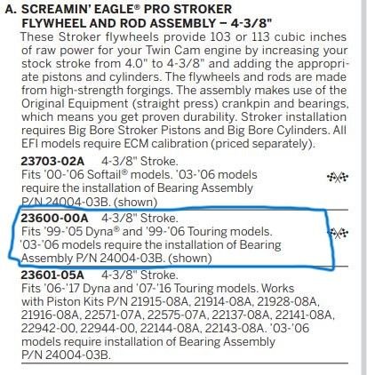

If the HD PN is 23600-00A, it is a direct bolt in; check the PN. JMHO but I would use the "Lefty" bearing 24004-03B on both ends.

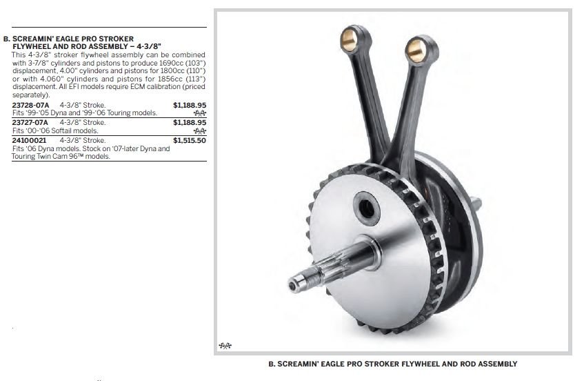

OK, so the way I read the two descriptions, the PN I posted, 23600-00A is clear that "stroker" pistons are required but there is no requirement for stroker pistons in the description for PN 23728-07A. Not being argumentative, but there is a difference in the descriptions that I am trying to decipher. So are you saying that the rods are different lengths one crank to another?

The 23600-00A is the SE crank option. It has the full width connecting rods at the piston pin. The 23728-07A is listed in the SE catalog, but is also the OEM crank for the 2005 SE Ultra. It has the later style OEM angle cut rods at the piston pin. Since the OP said he had the chance at a crank from a 2005 SE bike, it's more than likely the 23728-07A crank.
Thanks, didn't know the difference.
