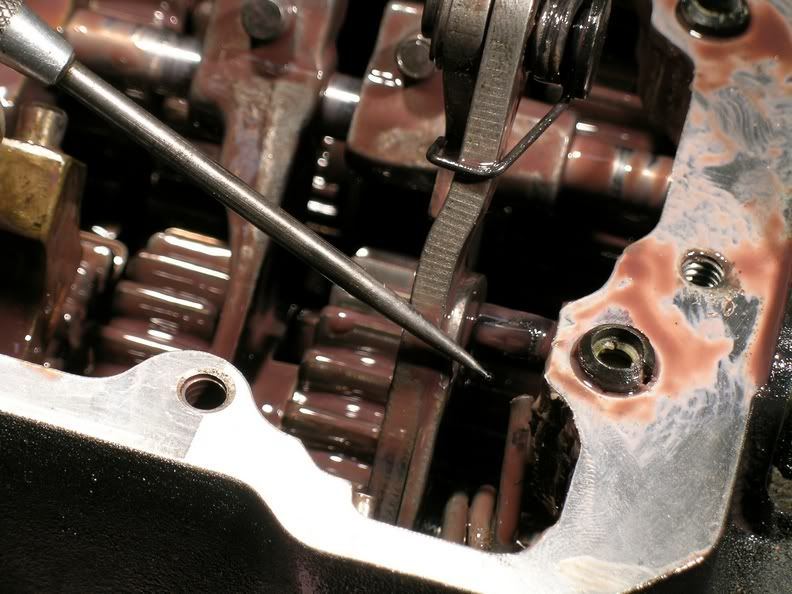

curiosity got the best of me so I removed the oil tank and the trans top cover. It's the pawl spring that broke but I don't see any other damage so now I'm left wondering where the noise came from.

The big thing with a pawl spring breaking is whether or not it went through the gears. I had one fail coming off the freeway while I was downshifting. Same as you, same noise, and a floppy shift lever.
Here's mine . . .
(If you see multiple bits of spring, like below, or bits that look chewed up, that means the spring bits hit the gears. You have to check every tooth of every gear to be sure.)
