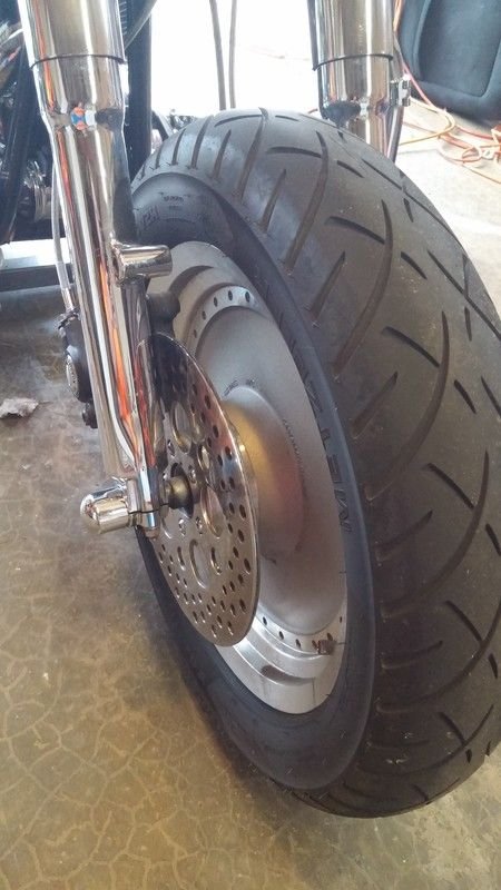

Some quick pics I just took, maybe someone can help me ID the front end?
And the speedometer

Did the '96 Softails come with LED odometer? This was when they changed it to coming off the transmission.
Quick google search http://www.2wheelpros.com/drag-speci...FdgRgQodm4ANhw

That is an aftermarket speedometer, if you look on the back it should have the ratio on it...1:1 2:1 2240:60
Since you mentioned it I looked on line and found its a Bikers Choice speedo. Im going to take it off this weekend and check it for numbers, thanks.
