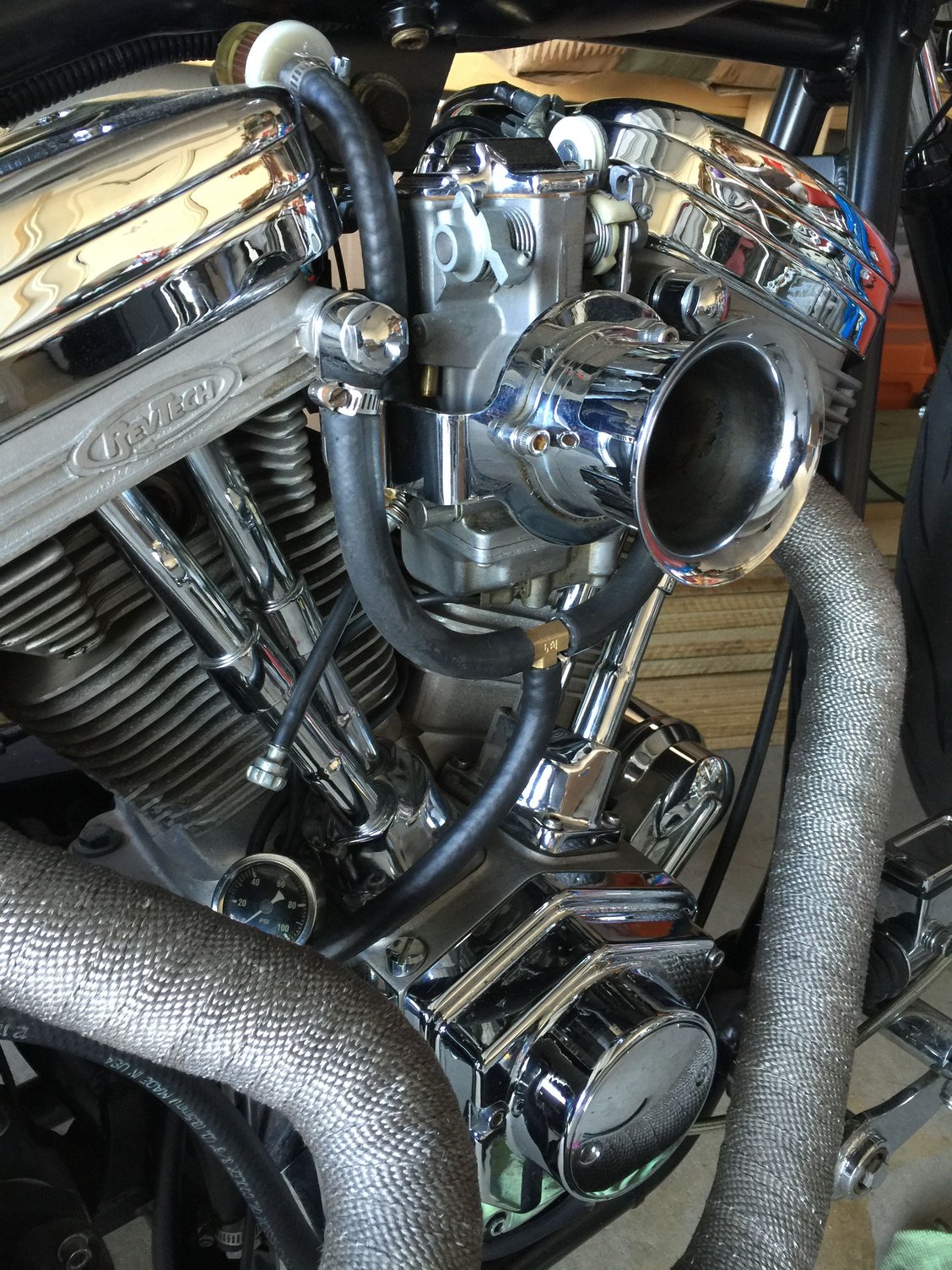

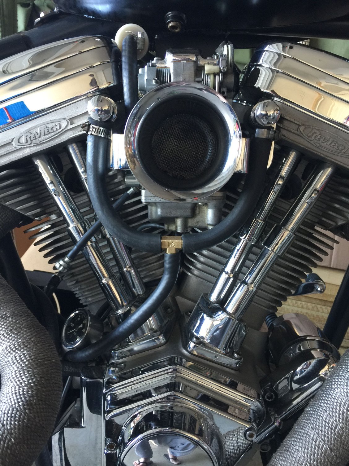

Ok so..... Got me an 88" Revtech, solved a leak so far, but realized it came from another problem. My problem was over pressurizing the case. I noticed my breathers were in a closed loop, causing my oil cap to pop off!
My remedy, I cut into the breather tube, inserted a T, and vented the heads under the bike via tubing.
My real question is, who makes a breather plate/assembly that connects to a Mikuni HSR42 carb and routes the breathers into the carb like a TC? Ness, fuel moto?
Any help would be awesome!

Old Apr 1, 2016 | 06:34 PM
Turret_plug's Avatar
Turret_plug
Joined: Jul 2012
Posts: 1,226
Likes: 7
From: Junction City, KS
My current plumbing...... Looks like dog ****!
