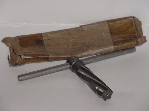

I fairly certain that the bushing is sized after installing it in the gear. The I.D. can change when it's press fit
You'd need one of these, or press in the bushing and take your drive gear and main shaft to the dealer or an indy, they will have the tool or hone it to size. :

There is a machinist slang phrase that reads : slip fit, no shake. Harley Davidson used loose instead of slip fit, no shake.
It looks as if the previous poster has the information that you need. Having that busing finish reamed is the best option and should not be expensive if you have a reasonably well equipped Indy close by. I wouldn't bother going to a dealer. Those guys don't even know that Harley Davidson made motorcycles before the twinkies.
