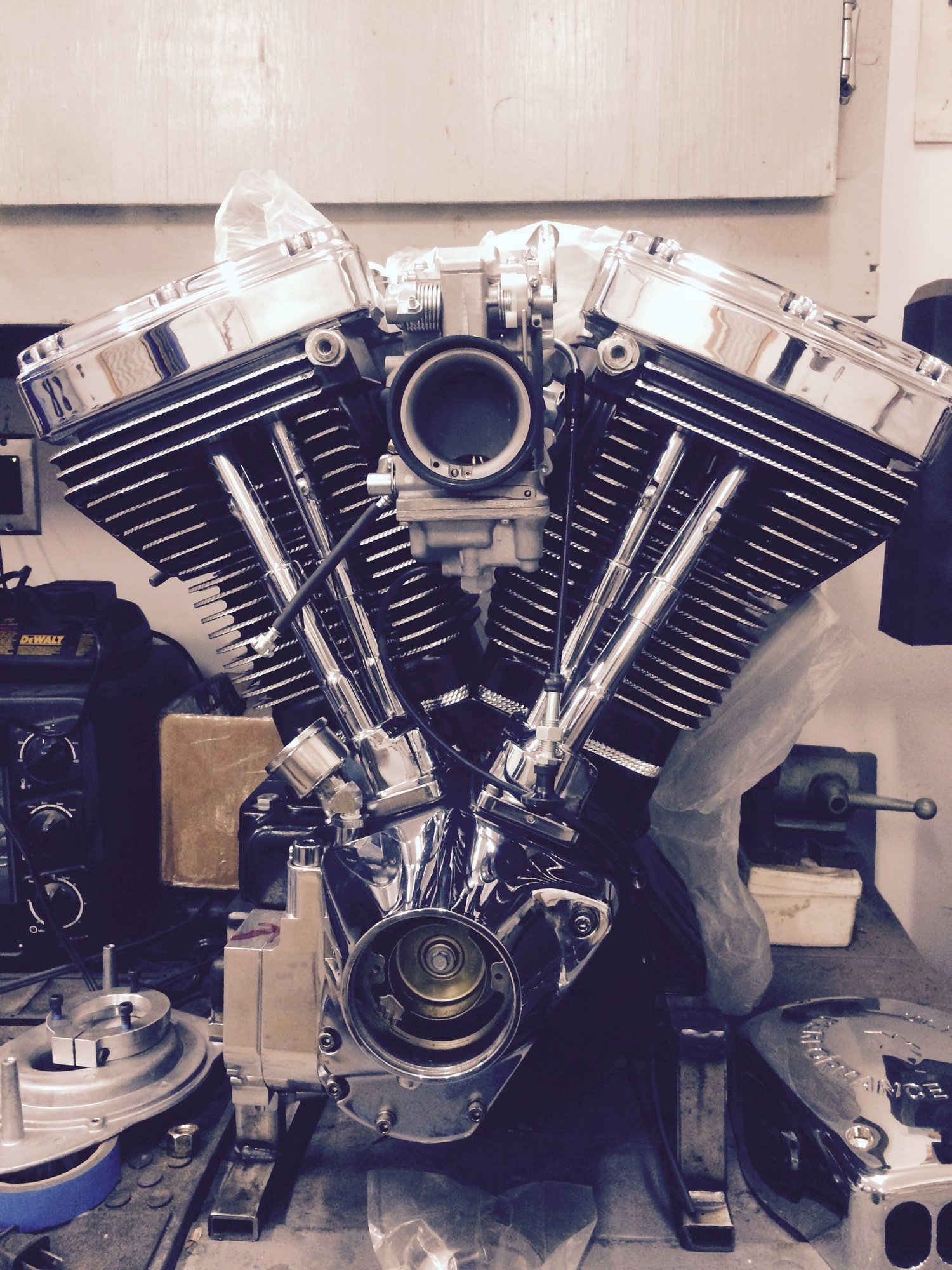

Little update... put 150 miles on yesterday, hit the reserve at 125 but that wasn't reasonable because of all the idling and tuning I was doing the past couple days...
Rode with my brother in-law and his friend. Both Street Glides, one a 103 with upgrades and the other an M8 114. Let me tell you even with my wife on the back neither bike had a chance.... we only did a roll on in 3rd gear but enough to know who was were in the chain of command..... LOL.... Definitely a great feeling..... Overall it might have felt like it was a little too rich so I dropped the main to a 74. Waiting for the rain to pass before I can get it back out....
I honestly believe this is the final build.. I am very happy with the outcome.... Time to Ride........

Your looks good lots of thought. Think I have about same amount of welding n my ports. Flow better smaller.

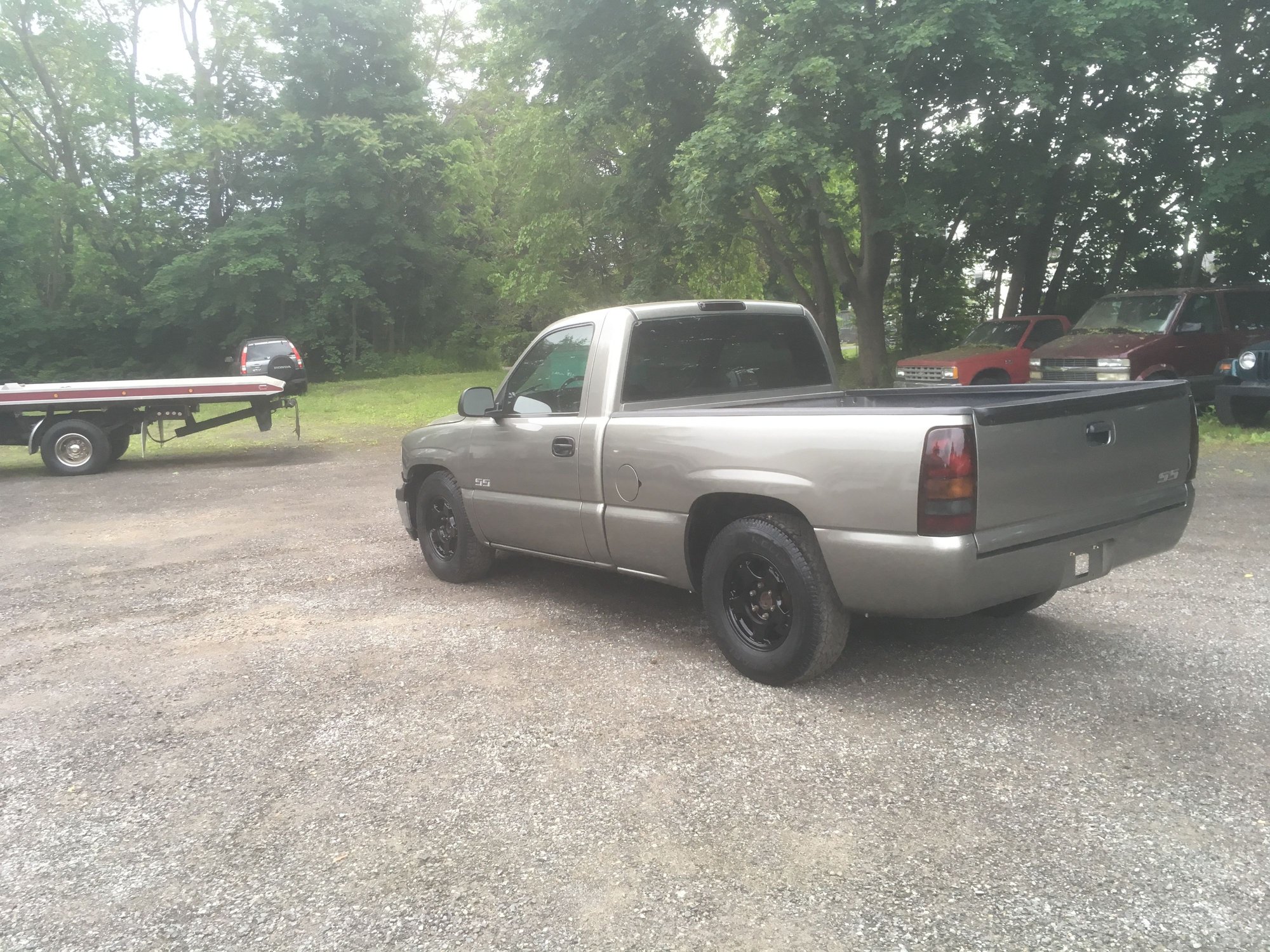

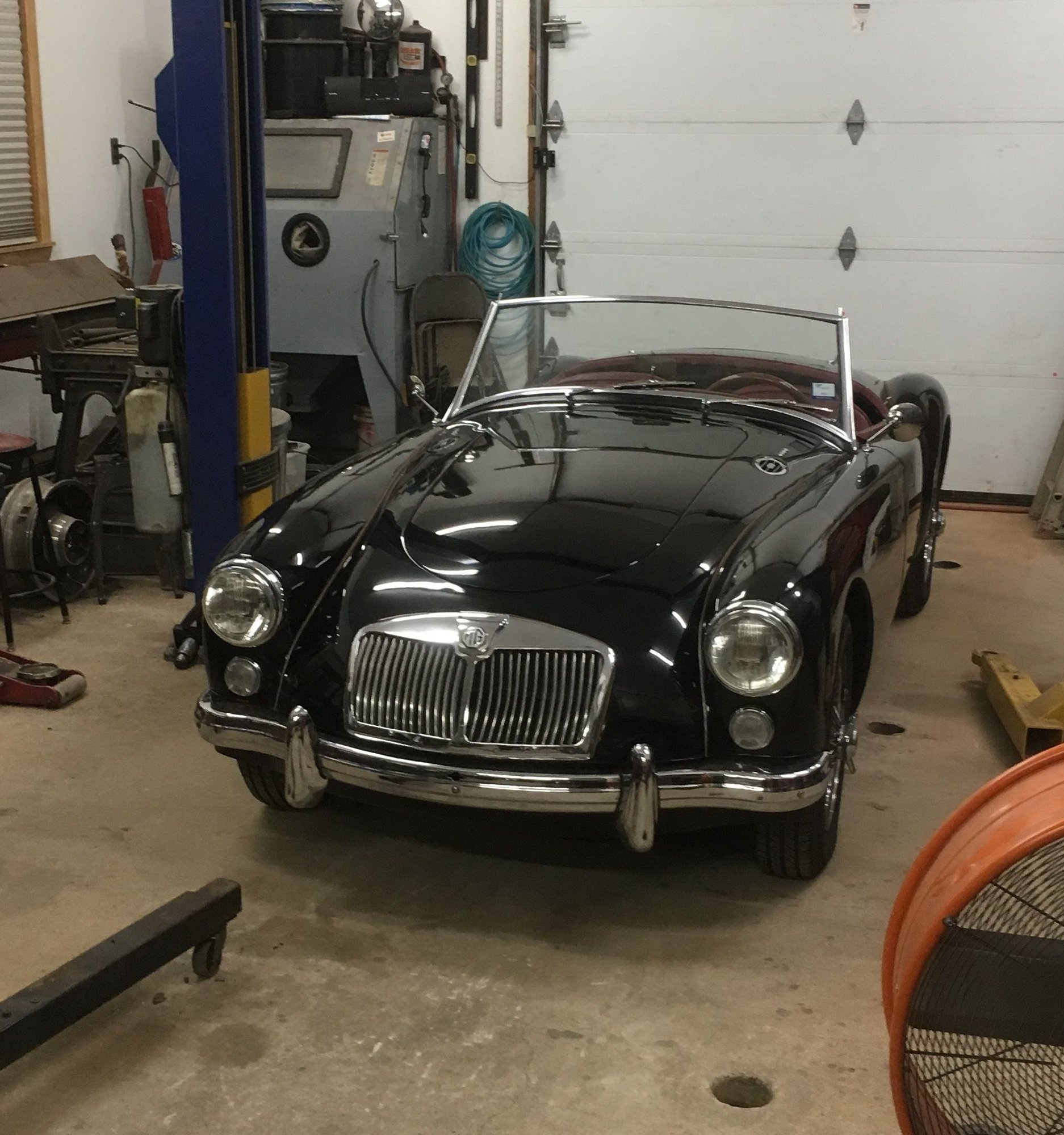

said the same thing except I get pulled in different directions. 62 years old and build more now than 10 years ago. But projects keep rolling in.
All of this crap came out of salvage yard and needed saving in last year. The 2010 soft tail only one hasp not finished. It's I friggin disease!!!! Back on EVO AFTER a couple Subaru timing belt jobs this week.
