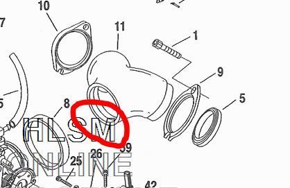

You know your way around the CV carb. Something to look at since you've made a thorough going of the carb. The manifold gets tired, and sometimes they will never seal correctly. When you press the CV carb on the manifold, it should be tight. If it's easy to get on and off, you will always have a potential leak, even with new seals. I've been told this by a friend who has hundreds of thousand miles on an Evo. I put a light surface lube on the rubber seals of the manifold that butts up against the intake ports, but nothing on the seal that the carb mounts to. The area that leaks is normally bottom part of manifold.

You want to leave the flanges loose on the heads then push the carb part way into the grommet. Attach the air cleaner backing plate to the carb and then loosely mount the backing plate to the heads, pushing the carb all the way into the manifold grommet. Then tighten the flange screws. This puts everything in a relaxed (where it's going to run) position. If it's an aftermarket air cleaner back plate, you may need to shim / adjust whatever mounting arrangement you have. Just be sure the carb stays straight and square with the manifold when it's all snug.
