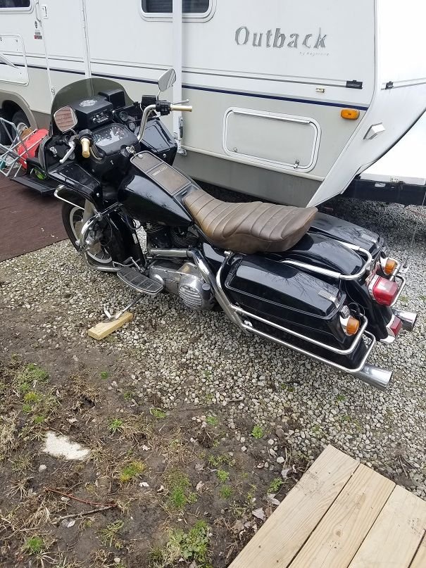

Not hard to set the bike up like a WL, if that is the riding position you want to go.
Hence police single seat to bring you up and forward, and 85 police bars to bring your hands bars back and lower as well.

Normally, would just push you to here,
https://partsfinder.onlinemicrofiche...avidsonmc/1985
But not showing for the 1985 FLHTP, which is the police version show above.
Maybe someone else has a source for that models microfiche, or at least has the seat assembly and bars parts list numbers, since all you would really need.
