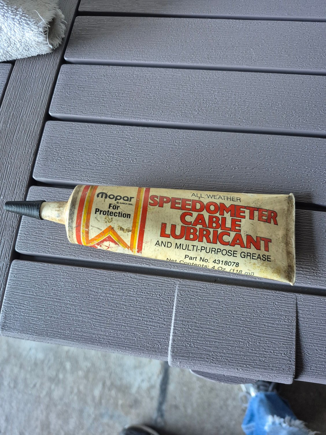

They do make a specific lube for speedometer cables.. Back in the '80s and 90s when Chrysler still use speedometer cables, we used to have to lube them every now and then because of noise and the reason why there's a specific lube for cables, in cars that is, is when it gets colder you'll get a drag on the cable with regular grease.. That's not to say you ride your bike in cold weather but it is formulated a little bit differently than regular grease.. Sort of like 5W-20 oil compared to 20w50 it's all about viscosity..
