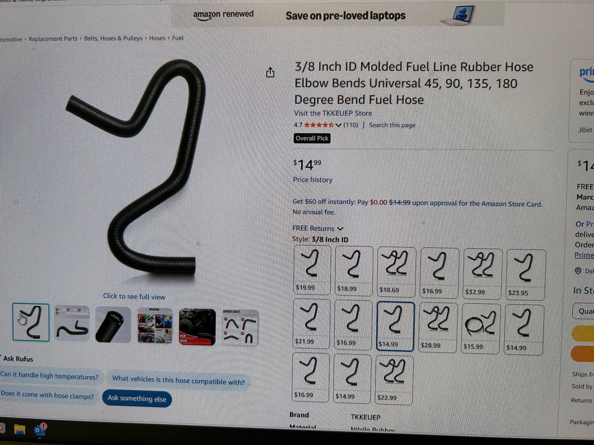

What’s the best/easiest way to replace these two pre formed lines out of the oil pump that 90? I ran all new oil hose but those two kink at the 90.

Assuming the OE parts are NLA ?
I googled "90 degree pre formed oil hose" Amazon had some with multiple angles you cut out what you want

If you go the rubber hose "universal" route, pay attention to some of those amazon specials. Need to make sure they are rated for the heat and has the fiber reinforcement/webbing molded in. While not a ton of pressure, there is some, and throw in the hot oil and you want it to be the best you can find. Happy hunting.
Metal 90* is a good idea if yo can get it to fit and rotate in such a tight spot. Pay attention to internal size of fitting as well. Some of those fitting can have a smaller ID than oem.
Disregard if just a vent line. Pretty much anything will work for that.
