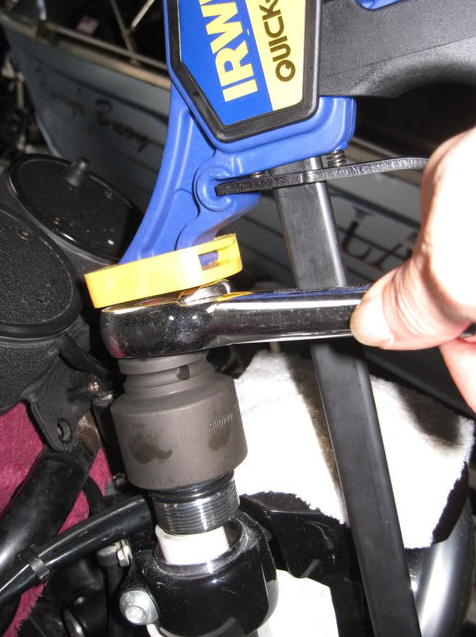

I thought I'd post this hoping it might help someone in the same position I was in the other day. That and nothing's on the boob tube.
I used a large adjustable wrench to get the caps off. That was no sweat. Getting the caps back on while fighting the spring tension turned out to be a PITA. I fought with it for 20 minutes and everytime it felt like I had the threads catching, it would just pop off again. It was making me nuts. I found a few tools online that would make this easy, but I wasn't waiting so I hit 2 auto parts stores, Home Depot and a sears looking for a 35mm or 1 1/8 socket. No luck. I stopped at Advanced Auto parts and found an Autocraft axle nut socket in 35mm for 16 bucks. It is a monster so I had to pull my handlebars off and lay them on the tank to fit the socket in, but it worked great. It was effortless. Now if I had used my head and had taken the bars off before, I prob could have gotten the cap on with my hands, but whatever. It was worth the 16 bucks.
Next time I plan to change my fork oil I'm going to get the purpose made socket for the caps. I found a couple online.
http://www.jpcycles.com/product/9100085
http://www.mbsmfg.com/hafocapnutso.html
http://www.motionpro.com/motorcycle/partno/08-0139/
Hope it helps-
C
Attached Thumbnails Fork caps socket...what I used-003.jpg   Fork caps socket...what I used-004.jpg

I bought the proper low profile socket with o-ring insert when I added chrome lowers to my wifes bike. I too found it a bit of a struggle to screw back on the cap. What I did was to take my 1/2" impact gun with the socket attached and push down on the back of the impact while turning the socket with a wrench. DO NOT USE AIR. The added weight of the impact gun helped greatly to compress the spring but, also acted as a guide to keep the cap straight while starting the threads.

I just cant compress the spring enough to start the fork tube cap. Using a socket and same as Terrapin88 did, I'm having a hell of time trying to get these on. First 35mm narrow glide (Aftermarket) that I even owned--the couple other OEM forks never had the springs this long. Its a 78-81 dual disc fork--the oem ones I have are another 78-81 and a 74-77.

Just saw this on another thread. Think this will work. Thank you WKNDS!!!
