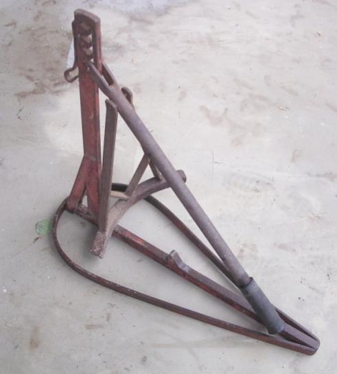

Originally Posted by Dr.Hess
Ooo-ooo, bumper jack and a truck not good enough for us, eh? Gotta use a bead breaker, eh?
I used a manual changer when I worked in a tire store nearly half a century ago. Not paying attention, I over inflated a 8.25 x 14 and blew the side wall out throwing me 10 feet and couldn't hear for 3 days with my right ear... we used hammer and chisels on concrete back then and used a propane torch to melt lead wheel weights for the anchor bolts.
But yes, I'm getting soft and sorry in my old age
