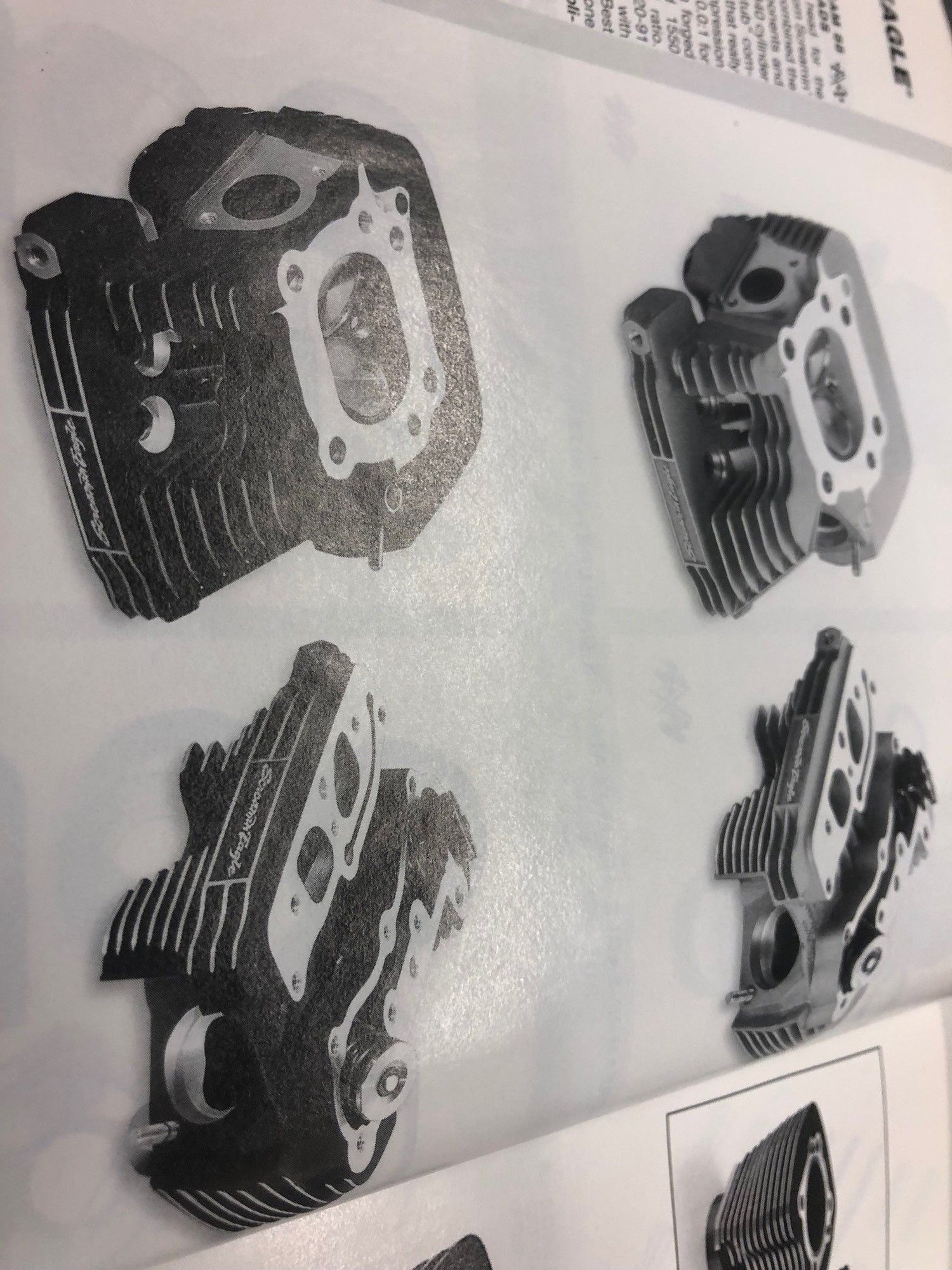

FWIW: these S.E. Heads show D shaped EXHAUST ports
Disclaimer the ad copy from the `03 P&A catalog makes no mention of CNC porting and states these are for carb bikes

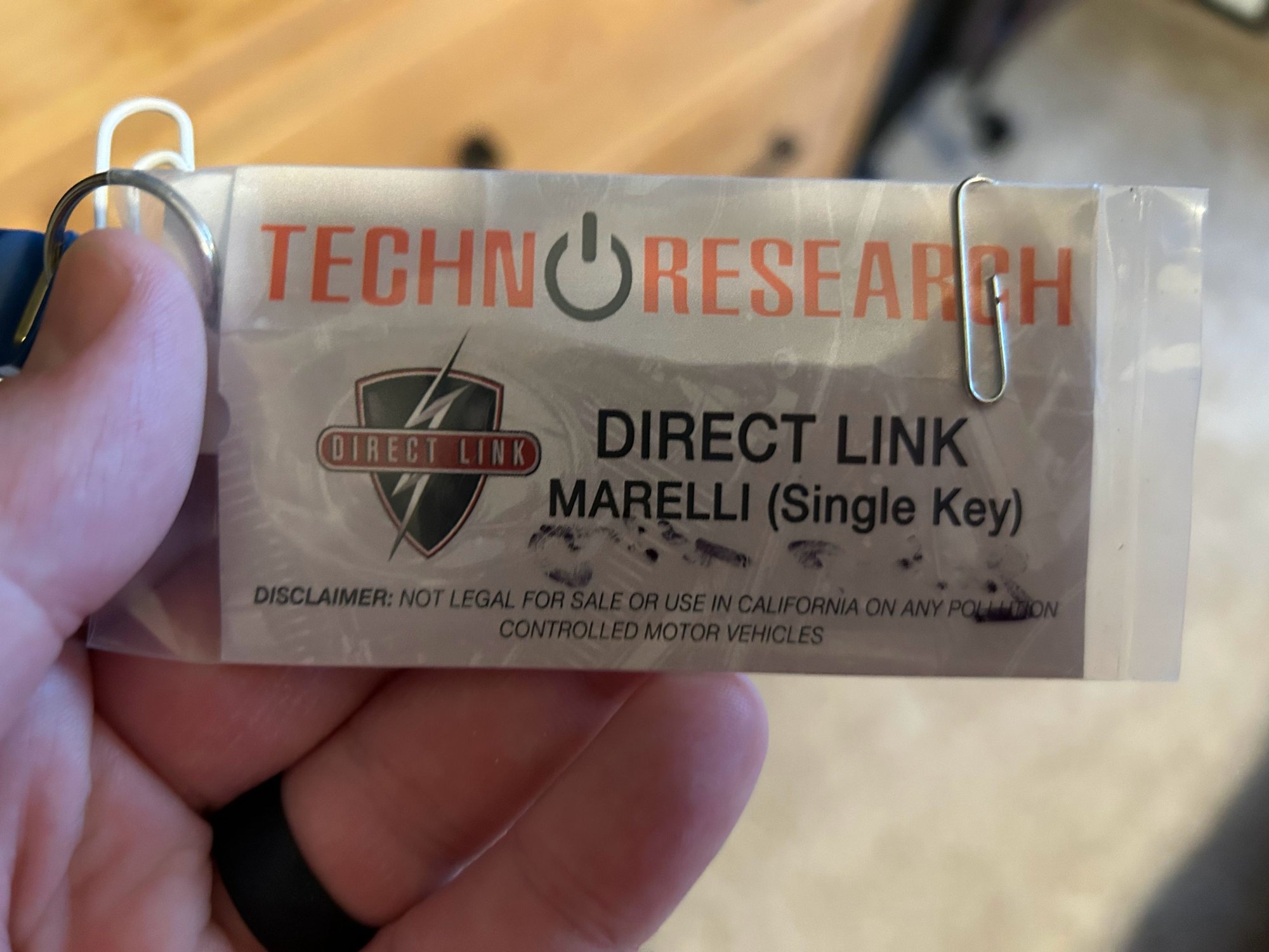

Yes, it still has the original Magnetti Morelli with a screamin' eagle intake manifold. The bike currently has this "Techno Research" direct link tune key. I don't know much about Techno Research and have read really good things about ThunderMax. Honestly, I want a pipe change for a new sound. The current Cobra is so mild/muffled, that it does not sound like a 114" Twin Cam. I want a more aggressive sound, as long as it performs the same or better.

That is a nice bonus (most of them get lost over the years)! That key allows a tuner with Direct Link Centurian to calibrate the timing & fuel tables in the original ECM for the components installed.
