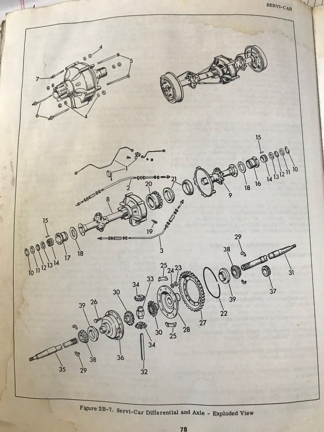

And here are the pages form the book, took my fat *** down stairs to get it, decided to stop being lazy:

my problem is getting the bearing (38) off of (36) on left side and (38) off of (28) on the right side. can i heat up the ends of (36) and (28) to slide them off?

while that is not a novis job you seem handy - the 36 bearing is pressed on the 38 stub and its tight are you sure they are bad normally its 14 and 35 are bad

Heat would work, or a jaw puller if there are recesses machined or cast into 36 & 28 so you can get behind the bearing.

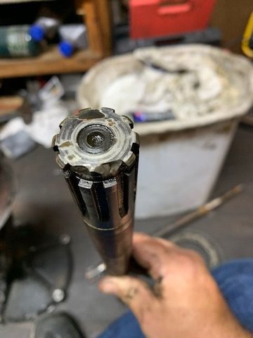

the original problem was a tire wobble on the left side after putting a new set of tires on. the first thing i thought of was bad bearings. i completely disassembled the rear end. used a puller on the left bearing and just bent the bearing up.so now i have to change it. upon inspection of the left axle, its missing 2 teeth and the 2 half moon rings are worn pretty bad . i have called around and looked on the net for a left side, long, 26 1/2 inch axle. haven't found one yet. if anyone has info where i can get a left axle, i'd appreciate it.
