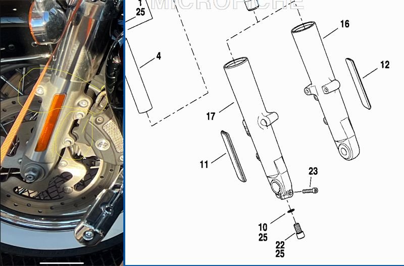

I can't seem to find the parts number for these circled bolts in the 2014 Road King parts book. I'm sure they didn't omit including them, but I can't seem to find them. Does anyone know?

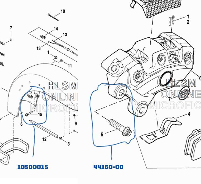

Looking in the wrong place?
I believe the top two are fender mounting bolts
(FENDER - FRONT)
10500015 SCREW
Lower ones are brake caliper mounting screws
(BRAKE - FRONT BRAKE CALIPER ASSEMBLY)
44160-00 BOLT, CALIPER MOUNTING, LOWER

1050015 for the fender screws
44160-00 for the brake bolts
