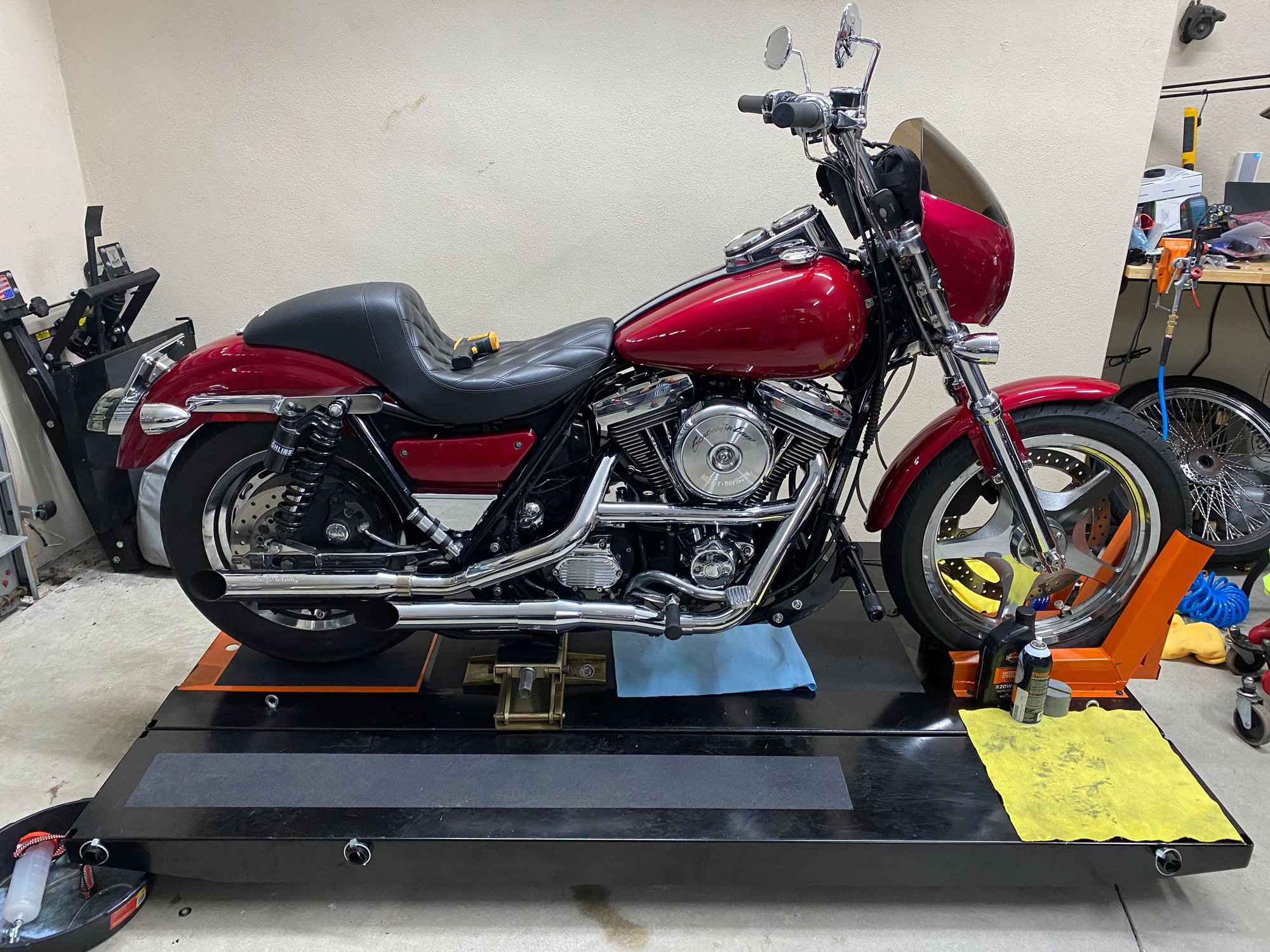

Anyone know the part number for a 39mm right fork, .75”. 2000+, chrome w/caliper standoffs? Now that my Hillside top end is done, running great, I feel like once i’m done taking it easy on the break-in i’ll need a little more stop then the single disc, even with the AN 15” rotor & +2000 4 piston caliper, provides. I put a +2000 on the left side six months ago but left the original on the right…
