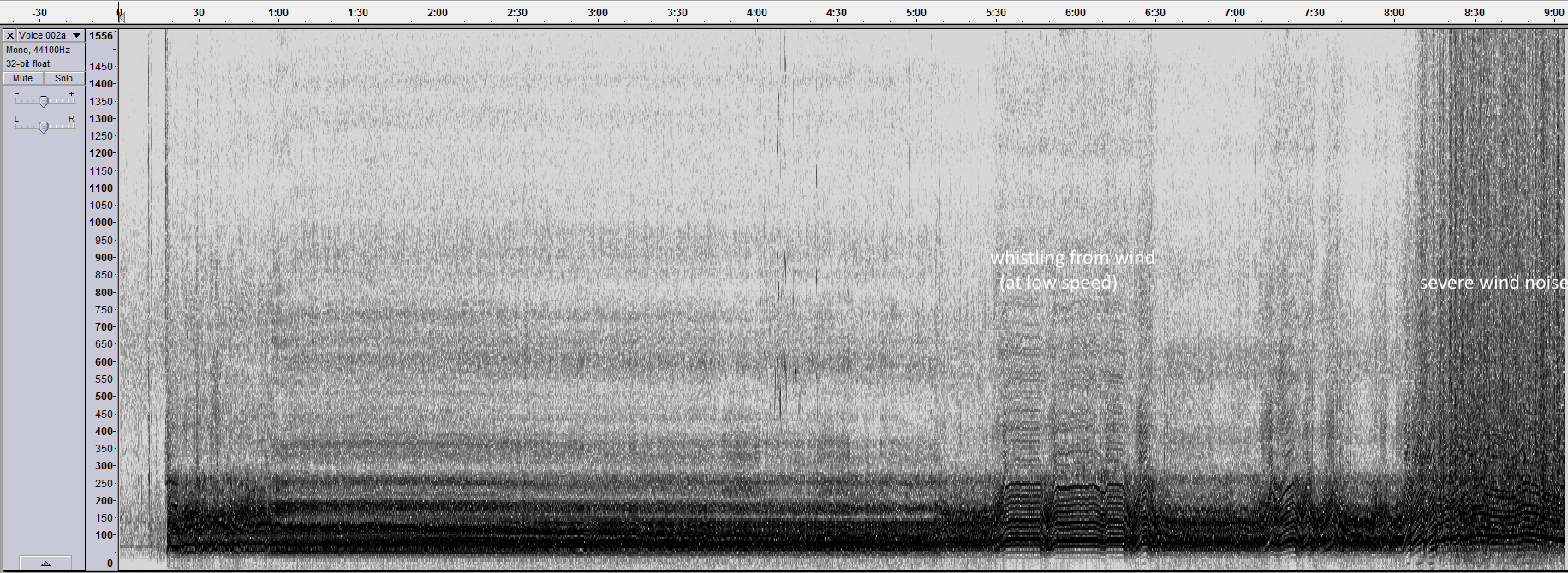

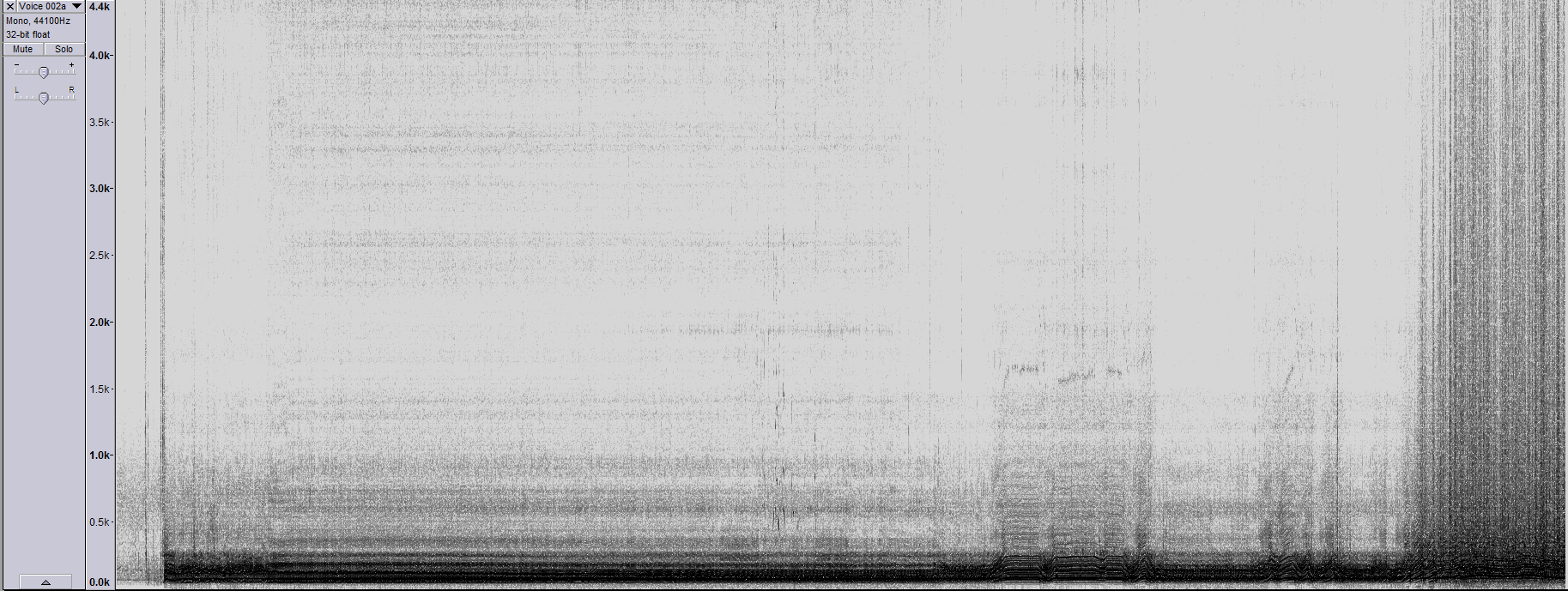

I am using Samsung Voice Recorder. The low frequency cutoff appears to be much below 300 Hz WHEN RECORDING. Here are two spectrograms of a RECORDING I made yesterday.
Full Spectrogram, not zoomed.
Zoomed spectrogram. Cutoff frequency when RECORDING appears to be below 50Hz. You can see the "ringing" caused by the wind when the bike is moving.
These spectrograms are from the recording I posted to the classified ads forum yesterday.
YOU DO HAVE TO LISTEN TO THE AUDIO ON A SET OF GOOD SPEAKERS, like on your computer. When you LISTEN on your cell phone you do lose all the low frequencies. But the low frequencies are recorded, you just have to playback on a set of good speakers.
