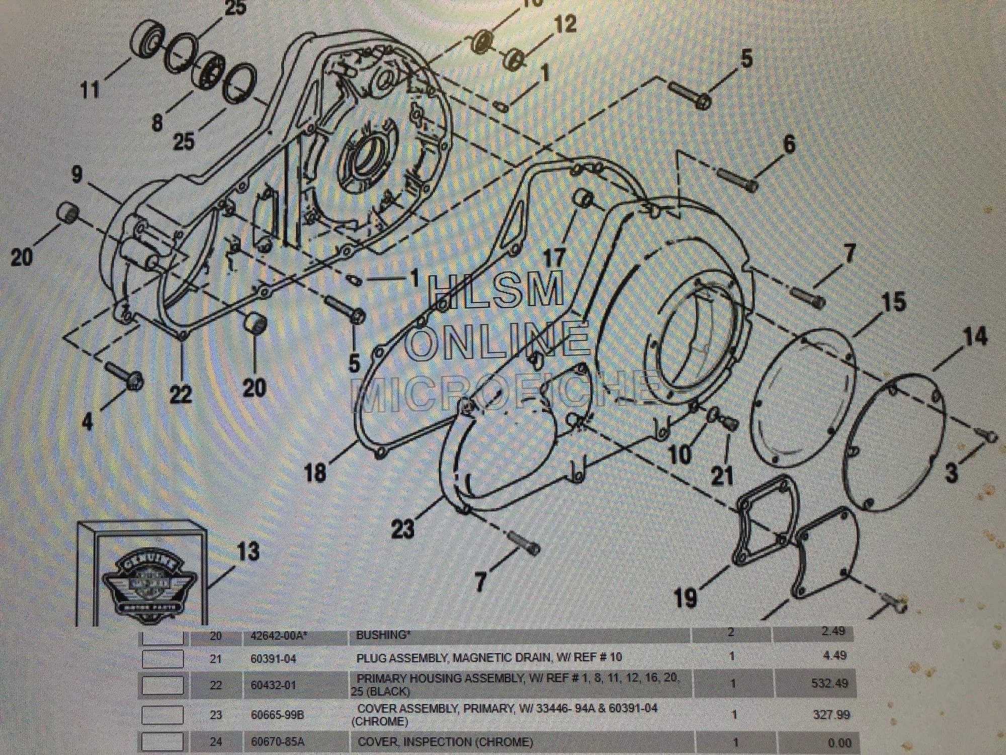

Let me try again
The `07 Iron horse pictures I see on line have an OVAL inspection cover/inner primary used on SOFTAILS thru `06
The trapezoid window is FL`s thru 06 .
You cant use one type on the other
Does your bike have an inspection cover and if so which one ?
I suspect it`s oval
( when S&S or I.H. built the bike is not helping us help you )

Top pic is SOFTAIL: flat top / oval window . inner is p/n 60630-94B
2nd pic is FL (bagger) : round top / funky window inner is p/n 60432-01
