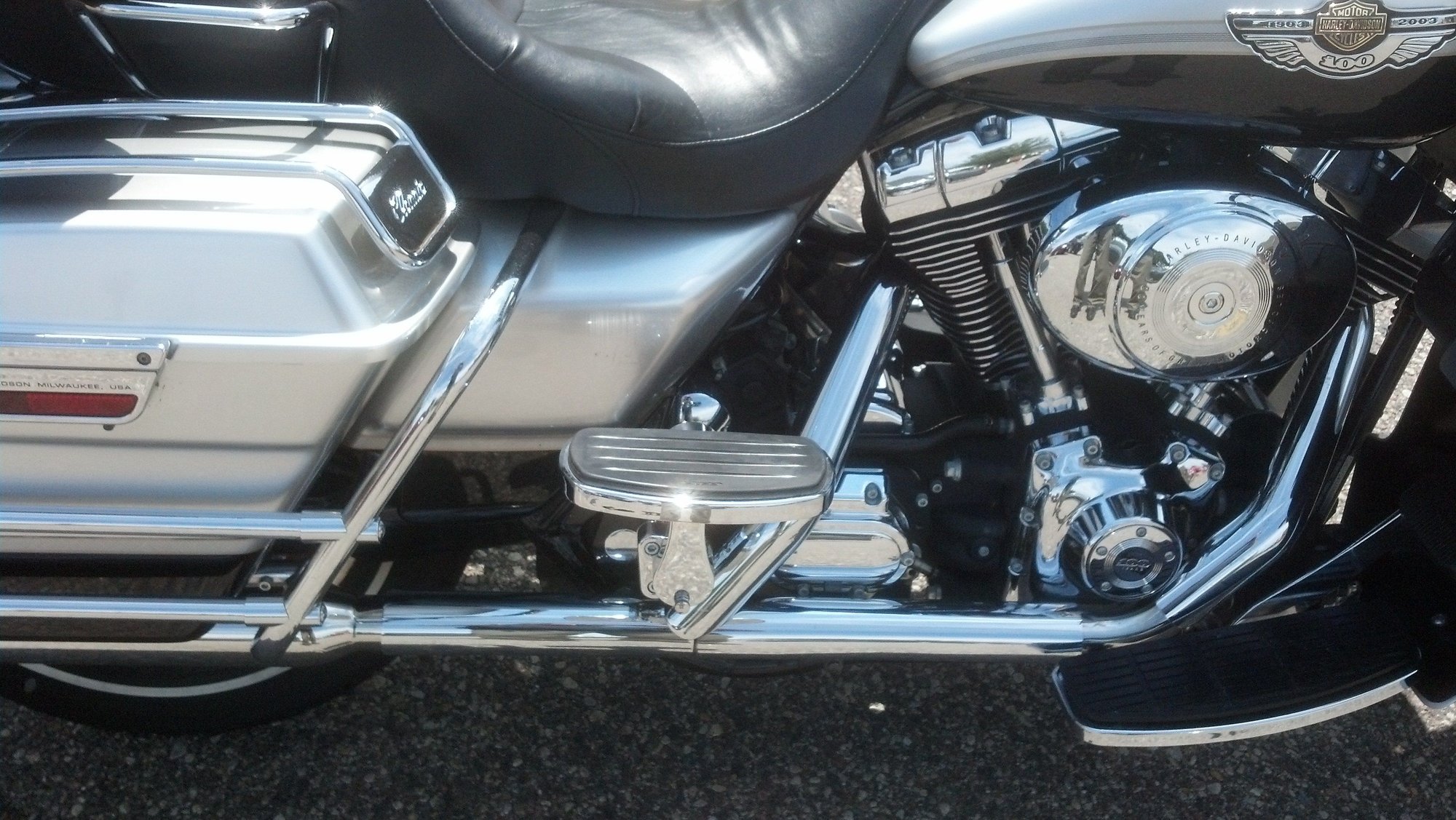

I bought Kuryakyn Adjustable Passenger Pegs last year, at a Harley Dealer. They were about $200. One side was loose, I had to take it apart and add my own blue loctite. It ended up getting loose again, later. The other side amplified the vibration of the stock floorboard mount, and caused the factory grade 8 screw to shear off.
So pretty much a waste of $200, plus the loss of $140 of stock parts on the right side.
So I did some research last fall, and decided to buy the Rivco pegs. Last week I bought them, and was a little worried that they wouldn't be worth it.
They gave me 10% off so I got the HD125As for $342. That includes two nice classic Rivco floorboards. If you want to use your existing floorboards you'll save about $45.
I put them on tonight. Excellent engineering. They have a mount to spread the pressure around, so I don't think the screw will shear. The metal is way higher quality than the Kuryakyns. Billet aluminum, triple chrome plated.
The range of movement is 360 degrees, and easily adjustable, although you can't do it on the fly. So if you are looking for passenger pegs check out the Rivco's at
