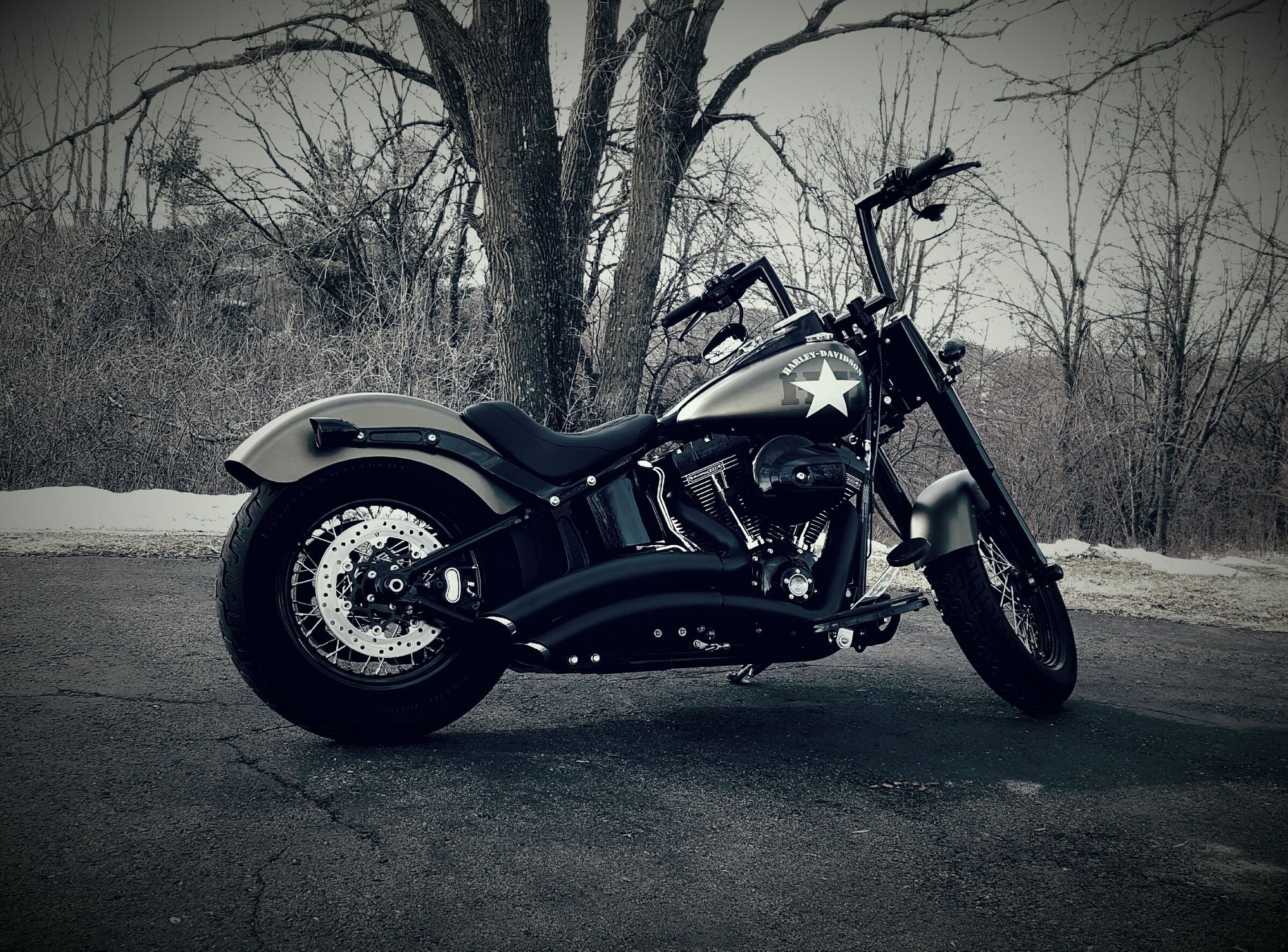

I just installed some Todd's Cycle 10" strip bars 1.5" on my 2016 softail slim s. It says it will not work with hydraulic clutch, it does. Wires will work just fine. I did have to order +6 clutch and abs line from magnum. I bled the abs with battery disconnected and abs works fine. ( No abs light) also ordered big buffalo risers from Dennis Kirk.
