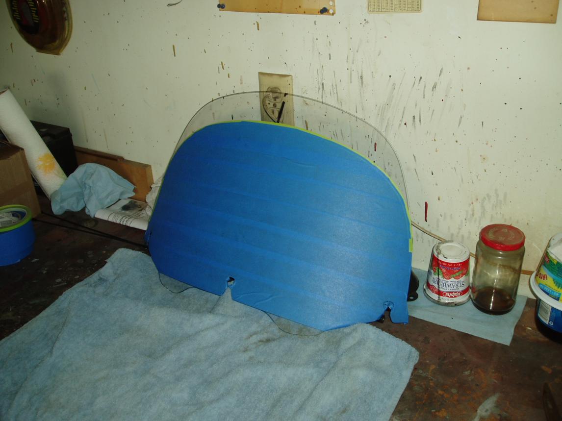

It's a piece-of-cake just as you described. I did mine on day one. Once you cut it with the jigsaw, use progressively finer sandpaper to give it a nice finished edge.
Attached Thumbnails Cutting A Windshield-2011-ultra-017.jpg   Cutting A Windshield-2011-ultra-018.jpg   Cutting A Windshield-2011-ultra-019.jpg   Cutting A Windshield-2011-ultra-020.jpg

For some reason when I cut mine it left a residue or pulled the hard coating off left blotches on it I couldn't remove. Use the 3M blue tape.

OP As you stated, fine tooth blade and blue painters tape. Sander on the edges, and you can carefully use acetate to cloud the edges.
