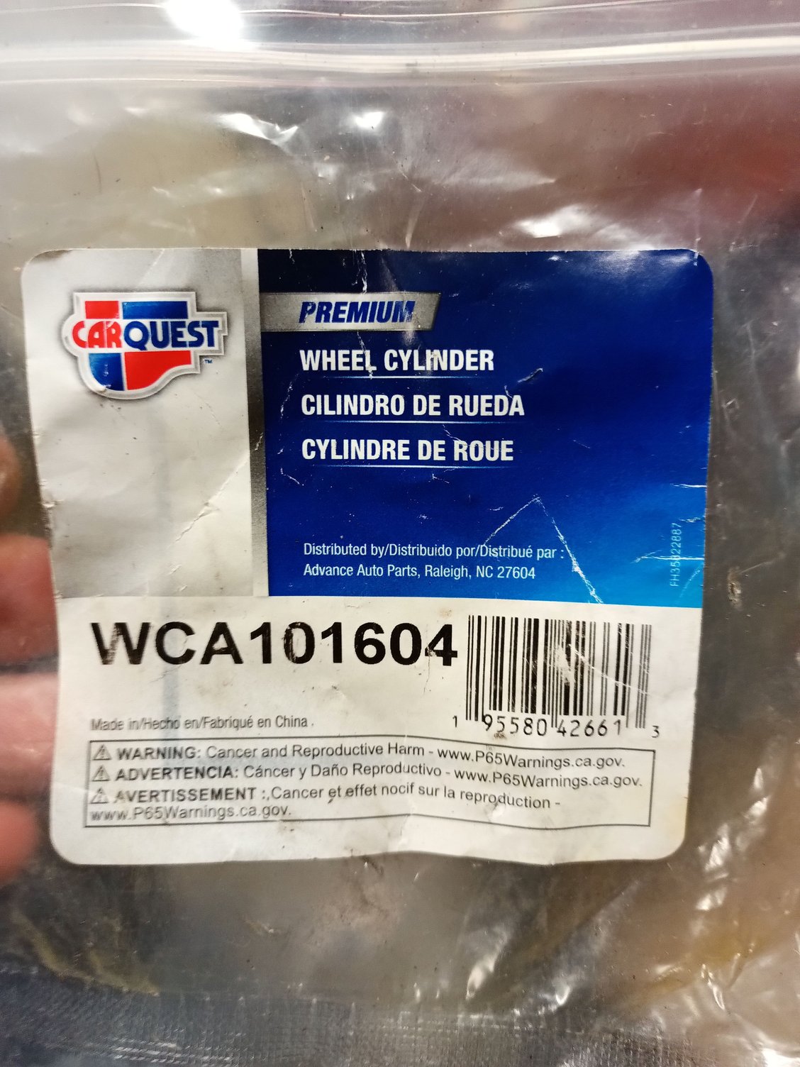

Default ​​​​​​​Lehman Rear drum brakes locking up
Originally Posted by chaz976
My trike HD Leman rear breaks lock up after the first use of the day need to convert to disk and would like a parts list of what l can use for this conversion if anyone has such a list that was done and proven to work with the original rear master cylinder please send it to me. Thanks very grateful for any responses thanks
Replaced the rear brake wheel cylinders, cleaned out junction block, bled brakes. The number for the rear cylinders on a Lehman) HD is as follows if any one needs the parts for their Trike...
I will keep you posted as to the progress after l finish my spring maintenance, and can test drive it...
