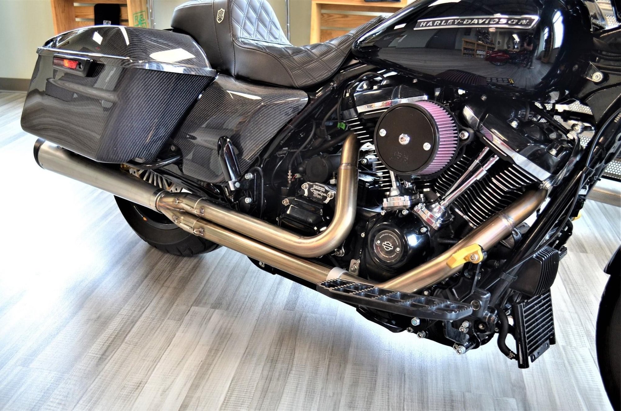

Some here may recognize this bike, not saying this makes it right but they too must have some reason for it.

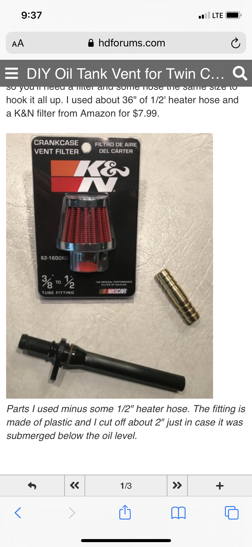

I was thinking about going the route, but $300 for it was a hard pill to swallow. I ended up venting the oil tank using a $5 fitting since I have a liquid cooled head. All in I did it for $20 and I don't have to deal with the vent line on the dipstick every time I check oil.
. How is this done? 2017 Ultra Limited
COVERS
On the water cooled models, there is a blank/plug (part #35) installed where the oil cooled engines have the oil return line. Remove that, drill and tap for a hose fitting and your good to go!
