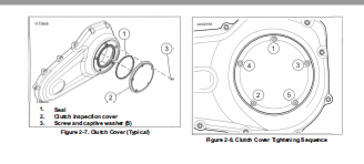

This is what is in the 2021 Service Manual

Thanks, I found it in my manual now and torque specs for Touring 2021 show 84-108 not 25-35 in. lbs. as $tonecold is showing. What manual is showing the 25-35 in. lbs.
That was the Softail manual. I'm surprised that there is that much difference between the Touring and Softail. That's the only 2021 manual I have.

One thing I do remember for sure, the small bolts that hold the clutch cover are super weak. I easily broke one putting the cover back on. After that I used an inch-lb torque wrench and followed the spec which wasn't much, maybe 25 inch-lbs?
If you go ahead and remove the clutch cover and get a look hopefully what I'm trying to say will make some sense.
